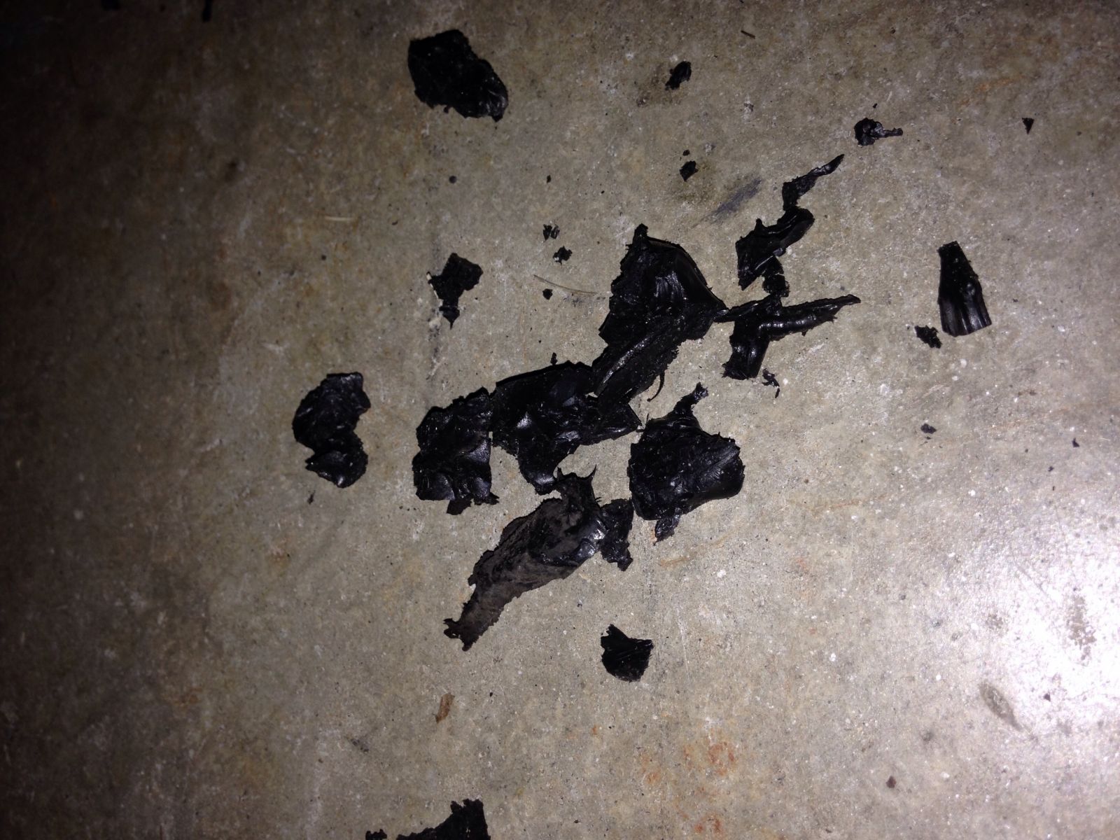

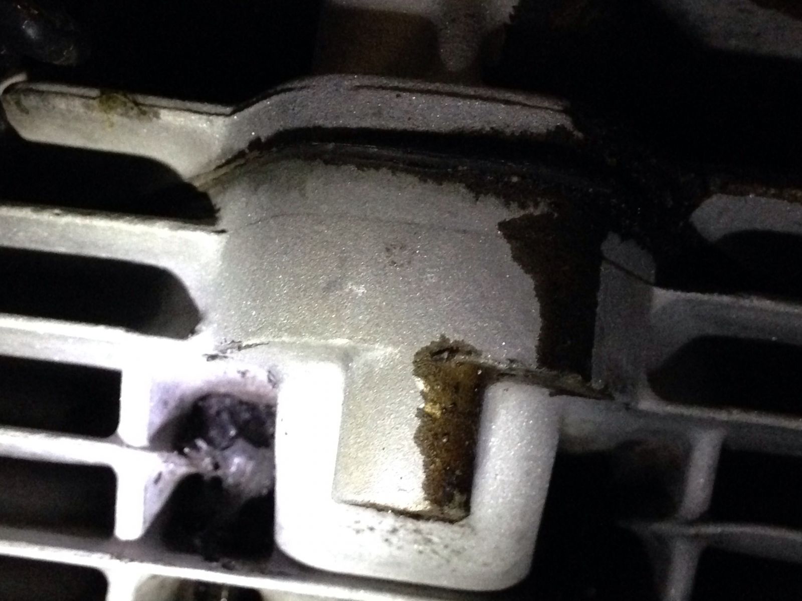

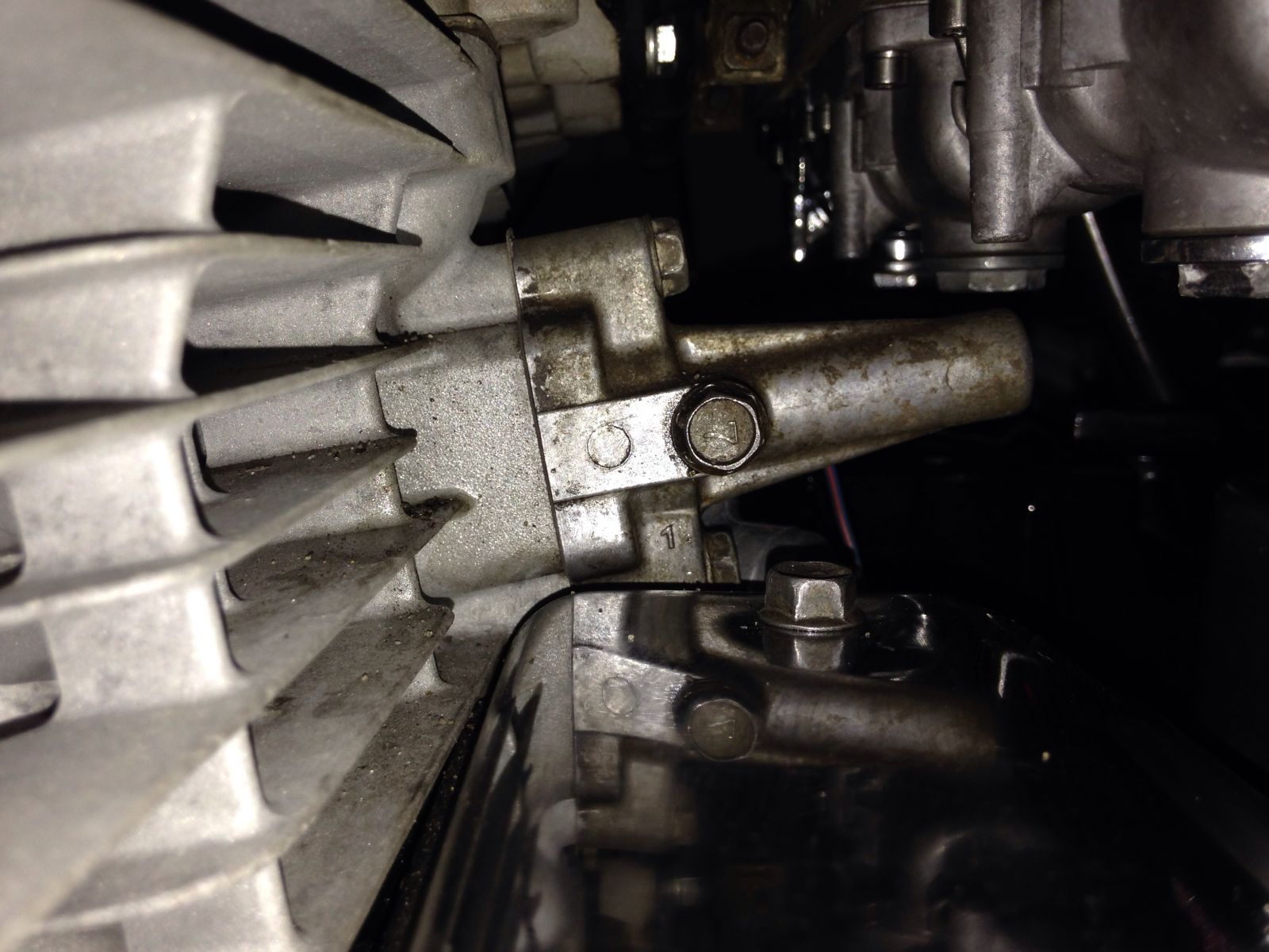

Well I clean the engine and notice some build up. At first I thought it was dirt min or a rock.
But it was silicon.....yes silicon on the left side bolt.
Oil is running between the center of block to the back.
Paper work that came with the bike say the base (fiber) and head gaskets were replace back in 7-13.
Bommer
Bommer

Is that a one piece head gasket on a 1015 motor?
