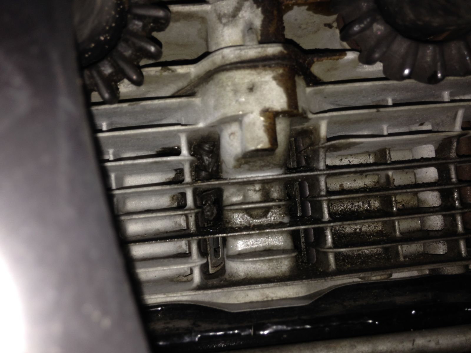

Well i had replace Tech seal and Vavle cover gaskets...but looks like oil leak coming from bewteen the block and head.
Will have to wait till next Winter for repairs.

Is that a one piece head gasket?

Did you try to Re torque the Head bolts, in the proper sequence ??

Just bout the bike two month ago.....If i open it up now ill want to do more then just the gasket needed.
So ill just have to wait....more of a reason to wash it more often :laugh:

Unless it it is gushing like mine was, I'd leave it be. I hated having oil stains on my left boot. Always seems to travel that way.

It appears to be running down from above that point, when looking closely at your photo.
If mine, I'd clean off all the oil evidence from the head and cylinder block, and check it again after a few rides. Don't tear it apart until absolutely sure where it is coming from.

I saw that too. Are you sure you don't have a crack in a bolt casting? There's no oil in the head bolt in that area.

my be a crack ...it looks like coming from between the block.
they are two expose head bolts..one on each side of the chain guide.
will wash again and look at it again after a ride.

If you wash it up good and then spray ladies antiperspirant all over and then run it you should be able to tell where the leak begins.

If the suspected area is clean & dry, you can pour some Baby Powder in the area, start it up & wait to see where it's leaking
