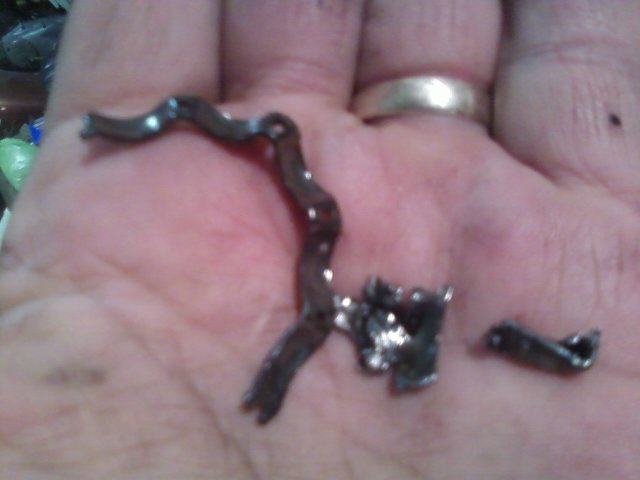

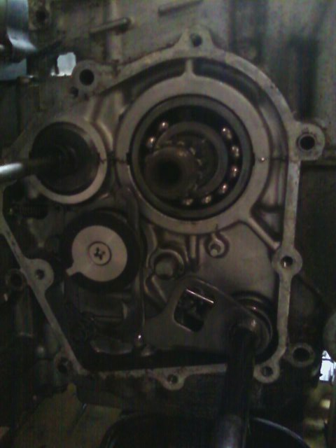

This is what can happen to you by using a chain that has sat for years.
And I soaked it in kerosene for a year prior to reusing it .
The price for a new chain and sprockets I think was around 125.00?
Having to replace that bearing might be less money but a whole hell of a lot harder to change :pinch:

I can't tell you how many chains and sprockets I've worn down to the nubs. I've taken out links so the chain would work. Never have I done damage like that. Didn't you notice anything? I've seen bearings like that. Sat for years, rust set in, came apart. How many miles on it? Did it sit?Where?
I agree, If the chain is noisy and the sprockets are sharp looking, replace as a set.
DAMN, I find it hard to believe a chain did that. It had to have had frozen links or something and no one noticed?

Yea, I don't think a chain can damage bearings. If it's lubed and still not seized up, and the sprockets have teeth, do the usual checks and ride on. Bearing possibly can be damaged by running an excessively tight chain I suppose, but that can happen with any chain regardless of condition if the owner has no clue in correct chain slack.
