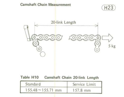

I have not cracked open the top end of the 77 engine that is in the bike now, just in case we get a decent day to ride , but I will measure the cam chain that is in the 78 engine and if it is within allowed limits I will probably stick with the original chain that is in the 77 now because it only has around 30,000 + miles at this point.
That way all the steel gears will still match up and I can just replace the rubber wheels and dampeners .
I am planning on using the head, jugs and piston off the 78 so I will need to make sure that the 78 piston pins and the connecting rods from the 77 are compatible, (with in tolerance )
