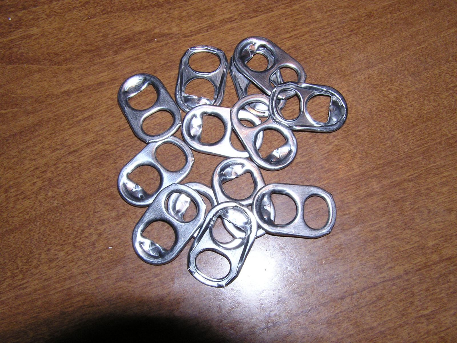

bluezbike wrote: Did you weigh the pistons with their respective pins?
Weighed the wrist pins and no help,
1-- 58.5 grams
2-- 58.5
3-- 58.8
4-- 58.8
This is what 3.5 grams of aluminum looks like .
