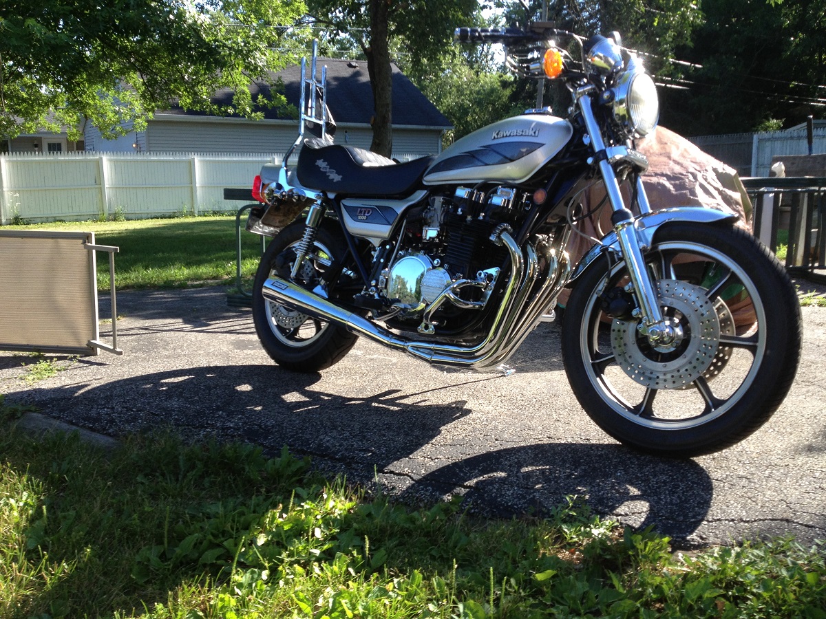

25 Nov 2014 10:53 - 25 Nov 2014 10:59I bought this Z1 new. I know what they're worth. The KZ's have parts that are interchangeable with the Z1. I'll give it to my children when I can't ride anymore. I hate it when I see a chopped up one.

That pic was when I started to put it back on the road. Here it is now.
