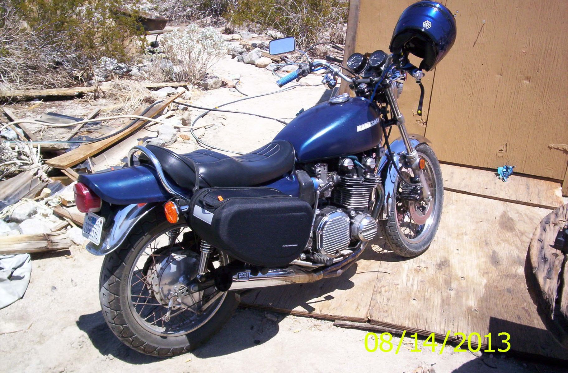

About 155/160. I was skinny until the wreck in 86. Everything changed. I'm 6'1" and 230 trying to get down to 195. My Harley Davidson jacket (made in China in 87) is so tight on me, I can bearley suck it up enough to zip it up. I used to swim in it at 185. I had health issues and bloted out. The bike raised my moral and I'm losing weight slowley.
I was almost done in.
Oh, here's a pic from last year when I first took a ride to my daughter's house.
Bossie's first run.
Bossie's first run.
