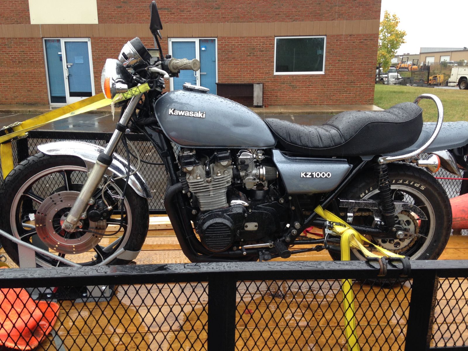

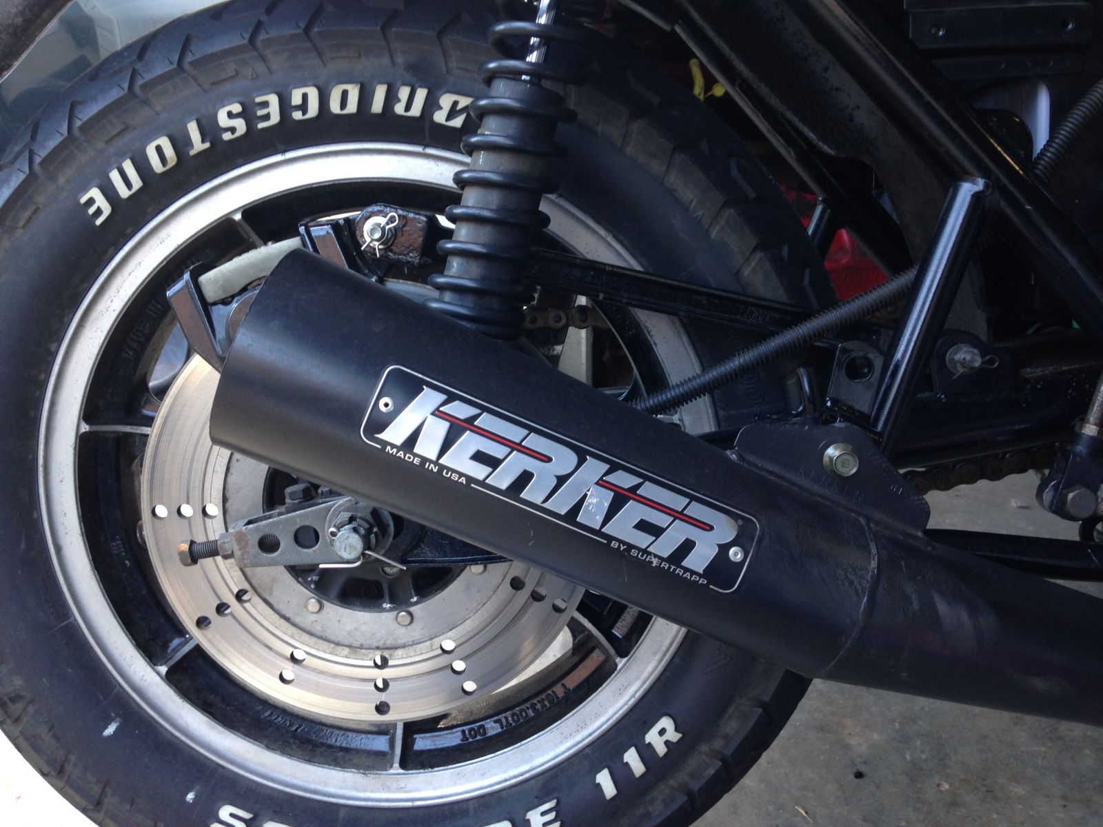

so here it is.....its a 79Kz1000 with a 1198 wisco kit 29mm smoothbore and web cams z4...
Bike came with over $1500 in recipts and a new Kerker Header.
Also has a electronic ignition , rectifier/regulader and some Nology Coils( nerver heard of them.
