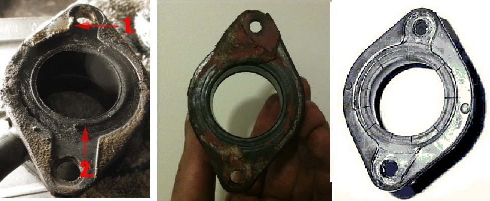

The carb holders are designed for fitment and function without any sealant.
Sealant may be applied as a temporary remedy toward preventing air leak through an old worn out carb holder, but is usually short-lived due to sealant being either fuel-resistant or heat-resistant, but not both. Some owners report better results when using a non-silicone based Three-Bond product to help seal air leaks.
Carb holders such as these should be replaced -- not sealed.

11 Oct 2014 18:17kzdcw wrote: Permatex High Tack Gasket Sealant. Gas resistant and temp. up to 500 degree F . Might be an option to use on the intake manifolds to provide a better seal.
Not for long. Replacement is the only really good option. Ed

12 Oct 2014 00:34650ed wrote:kzdcw wrote: Permatex High Tack Gasket Sealant. Gas resistant and temp. up to 500 degree F . Might be an option to use on the intake manifolds to provide a better seal.
+ elevendy billion! I tried sealant on them, even cut some paper gaskets for them after two kinds of sealant failed. The paper gaskets held for a few decent trips and then back to leaking. But it was enough to let me know I definitely had vacuum leaks under the holders. The new ones have a raised ring that compresses to make a nice seal. $70 for the set but WELL worth it! I'm thinking of buying another set to keep squirreled away in case I ever get as old as Ed and still have the bike.
Eventually the holders will all be gone and there will be many of these bikes still on the road. Another option must eventually be found, but for now.....buy new ones!

12 Oct 2014 07:20Most factory installed carb boots Ive seen had a little bit of some form of 3 bond on them.Patton wrote: The carb holders are designed for fitment and function without any sealant.
