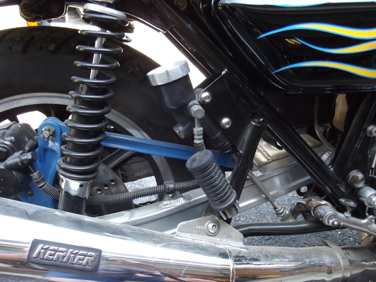

Re: LTD Exhaust
14 Sep 2014 14:40
#647514
NO Duane, you can only raise or lower the muffler so much, before you start putting excess pressure on the exhaust flange studs, that's why you'll have to make some sort of bracket
for instance, this is my 76 LTD with a Kerker, I made a 3 inch bracket from the muffler flange to the foot peg hole

  • pete greek1
  • pete greek1's Avatar
  • Posts: 1510
  • Thanks: 185
Re: LTD Exhaust
14 Sep 2014 14:45
#647515

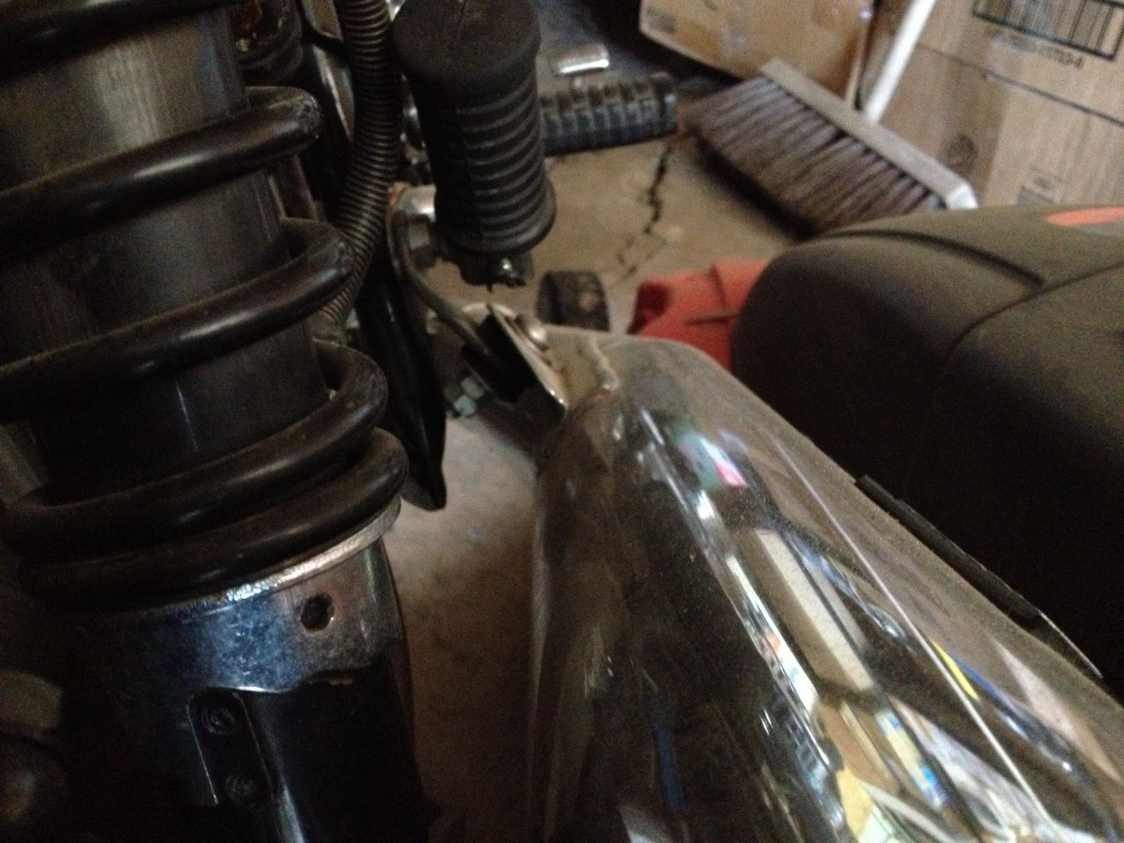

Re: LTD Exhaust
15 Sep 2014 11:12
#647637
I had to deal with that problem as well. As you see I don't have a 75-6 with different mounts. Mine looks just like pete's post. I have a custom bracket to make it work. One straight piece of metal bent at two places and it will mount right up.
I'll post up a picture of it shortly.
