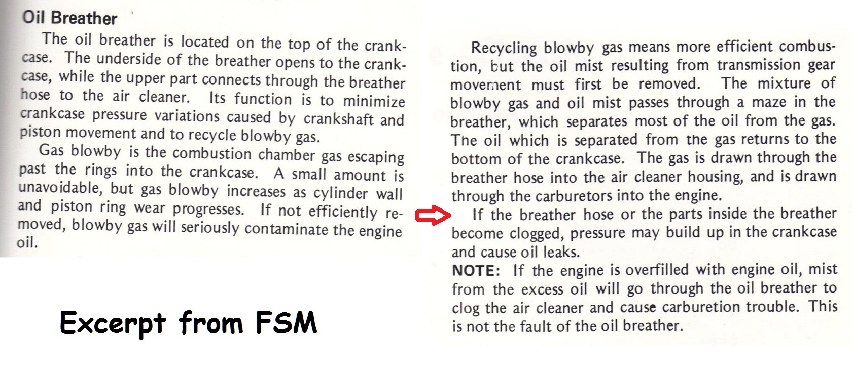

The first thing I'd do is check the oil level to make sure it isn't over filled --- bike level & on the center stand.

overfilled with oil or piston/cylinder clearance scoring blow bye....... :ohmy: if not overfilled with oil do a leak down test :blink:

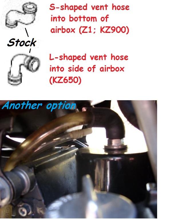

Take that k&n filter off of the crankcase vent.
Run a piece of clear vinyl tubing from the vent up bottem of seat,zip tie it to frame to keep from kinking then loop it back down towards the rear tire.

All motors will create oil vapours, particualy high power small jap bike motors. Bore it out and the problem is worse.
Usually on a standard bike the vapours vent back to the airbox. When you lose the airbox a catch tank is better like on race bikes.
On my former yoshimura gpz I vented the rocker cover and the clutch cover to a catch tank. Some oil residue is normal, too much is a problem.
If the bike is smoking heavily then that is a sure sign that you have excessive cranckcase compression.
Never really believed in filters here , a tube to a vented catch tank is better imo.
In the uk it was 'normal' to have pods and a breather pipe vented to a beer can on tuned bikes. Some race bikes even used the hollow swinging arm as a catch tank.

21 Aug 2014 03:22 - 21 Aug 2014 03:26The oil breather may be vented by a hose routed to exit underneath the bike.
Normal engine performance should not produce a discharge of liquid oil from the hose.
An aftermarket filter added to the breather or at end of hose is imo a worthless troublemaker, except of course in the unlikely event where needed to prevent alien oil-ravenous lifeforms from entering the breather.
A catch-can is used in racing situations to help avoid any expelled oil from being deposited onto the track surface.
