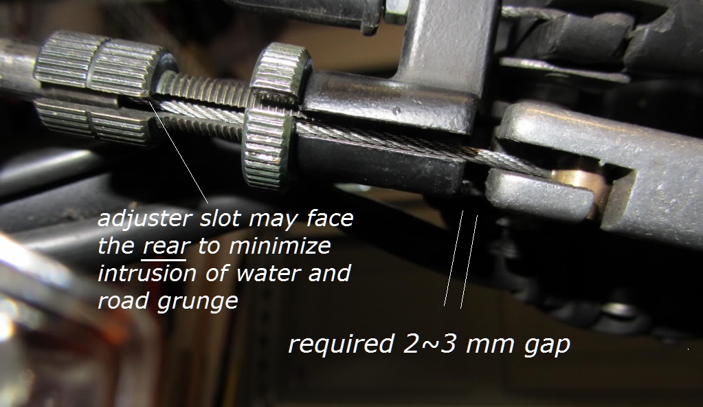

As Motor Head noted, the spring applies mild pressure toward keeping the lever against the perch, which avoids slop at the gap area, so the lever won't flop back and forth against the perch.
Replied by Patton on topic Clutch cable spring
Attachment Screenshot2014-07-29at10.16.05PM.png not found
Motor Head wrote: That spring takes any slack out of the cable, making the lever return against its perch., keeping a bit of freeplay at the push rod to worm gear in the side cover. With a safety switch on your clutch lever, if it didn't return all the way to the perch it may start without the lever pulled in.
Doubt you really need the Kawasaki spring. Ace Hardware or Lowes, or any good hardware store with a selection of springs should have something for about a buck.
