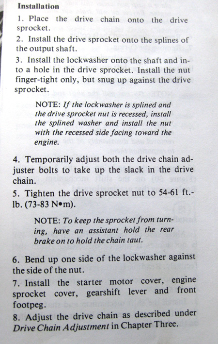

Thanks for the reply 650ed.
First- Indeed my Clymer manual does indeed state to tighten this nut only "finger tight"
Second- #43 seems to identify the nut in question. Here is the link to actual nut purchased:
www.z1enterprises.com/ItemDetails.aspx?i...x+P1&item=92015-1210
Third- In the past I had no problems shifting in to higher gears with the back wheel not spinning, but with that being said I cannot even shift in to first gear from neutral. I have also been reading about this neutral lock, which I will admit, I was not aware of so maybe some of the problem lies in there?

If the Clymer manual says to tighten the engine sprocket nut "finger tight" throw that manual in the trash can before it gets you into BIG trouble, and buy a Kawasaki Service Manual. Be sure to get one for your exact year/model as there are some differences in some of the systems; they usually are available on eBay.
Notice in the excerpt below the torque spec for the KZ650 engine sprocket nut is 54-61 foot pounds. Even King Kong cannot apply that much "finger tight" torque!
Regarding the shifting problem possibly being the result of adjusting the clutch - YES! If the clutch adjustment instructions in that crappy Clymer manual are as bad as their torque advice who knows what you have done to the clutch adjustment. Again - I would re-adjust the clutch using the instructions in the Kawasaki Service Manual and see if the problem goes away. Ed

Re: '78 KZ650B won't shift gears
It does, yes - however it does suggest a bit more if you continue to read step 4 - 8 below the note.
28 Jul 2014 11:53That makes more sense! I'm no big fan of the Clymer manuals, but even I didn't think they would recommend finger tight sprockets. :laugh: :laugh: Ed
