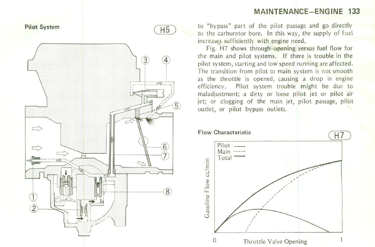

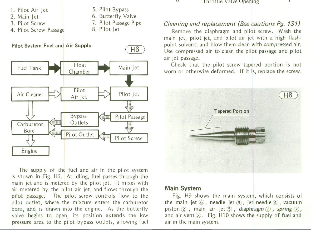

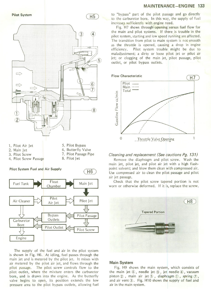

CoreyFord wrote: ... 82 csr 750... will not rev up. idles fine. if you give it the slightest throttle it will rev up to about 1200 rpm if that. give it anymore just bogs down... if you spray starting fluid in the air box it will rev up. I have clear fuel hose on it and see fuel flowing. Just need a direction to go....
if you spray starting fluid in the air box it will rev up -- imo, would indicate that the carb pilot circuit is not yet perfectly clean.
If needed, this link enables downloading a 1982 KZ750 twin manual, which I believe (but am not positive) is same as the carb at hand.
bublicpucket.s3.amazonaws.com/Manuals/ka...llwith80and81sup.pdf
Here's an excerpt from page 133 that addresses the carb pilot circuit:
Would spray pressurized carb cleaner through the pilot passages until the spray squirts through the orifices into the carb bore, and keep spraying until certain that both orifices are perfectly clean and clear.
