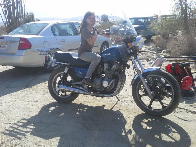

Got an 82 kz550. I start it an let it warm up. But when I pull throttle back it revs high to 3000-6000rpm then comes back down to 1200 which is normal I think. When I give it a little throttle while riding it seems like it's dragging but if I gun it she goes full blast an dosnt seem sluggish anymore. I haven't cleaned carbs or even looked at them. I am new to this bike thing and this is my first bike. It has 7,000 miles on it. When I got it I did oil change and spark plug change. And knocked some rust off the chrome. Idk where I should start so any help would be good.
Thanks
Con
