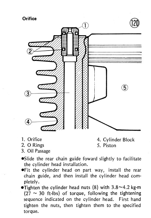

Could be piston rings. Could be a head gasket leaking as well as the O ring seals for the passages going up to the head. On my 750 twin, there are two oil pipes with two O rings each connecting the cylinder to the head.

The part numbers show up as:
92055A in the drawing and P/N is 92055-094

Weird. It seems like my oil passages dont have a groove cut out for the O ring. I attached an old picture I took during a rebuild awhile ago and while it is sort of difficult to see, there does not appear to be any groove for an oring. Does it just sit on the nipple?

On mine, the pipe has a groove on both ends. One O-ring seals into the cylinder and the other into the head. Maybe yours is different.

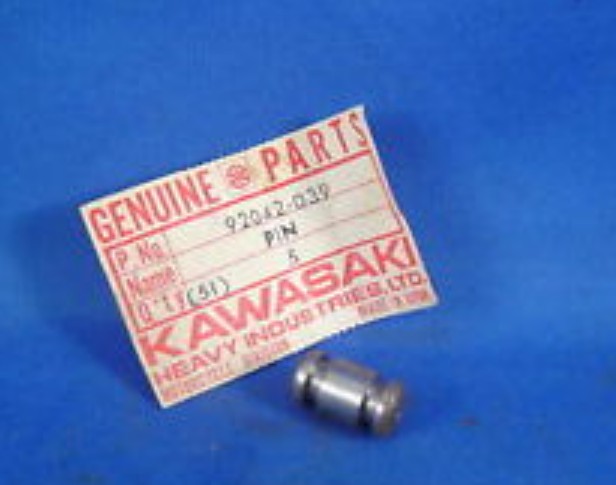

Bountyhunter, do you think you could give me the part number of the oil passage pin that is correct? I think a previous owner may have switched it out with one without grooves? Whatever happened, mine are smooth and i suspect it to be the cause of the leak.

No eBay APP ID and/or Cert ID defined in Kunena configurationThe number shown is 92042-039.
