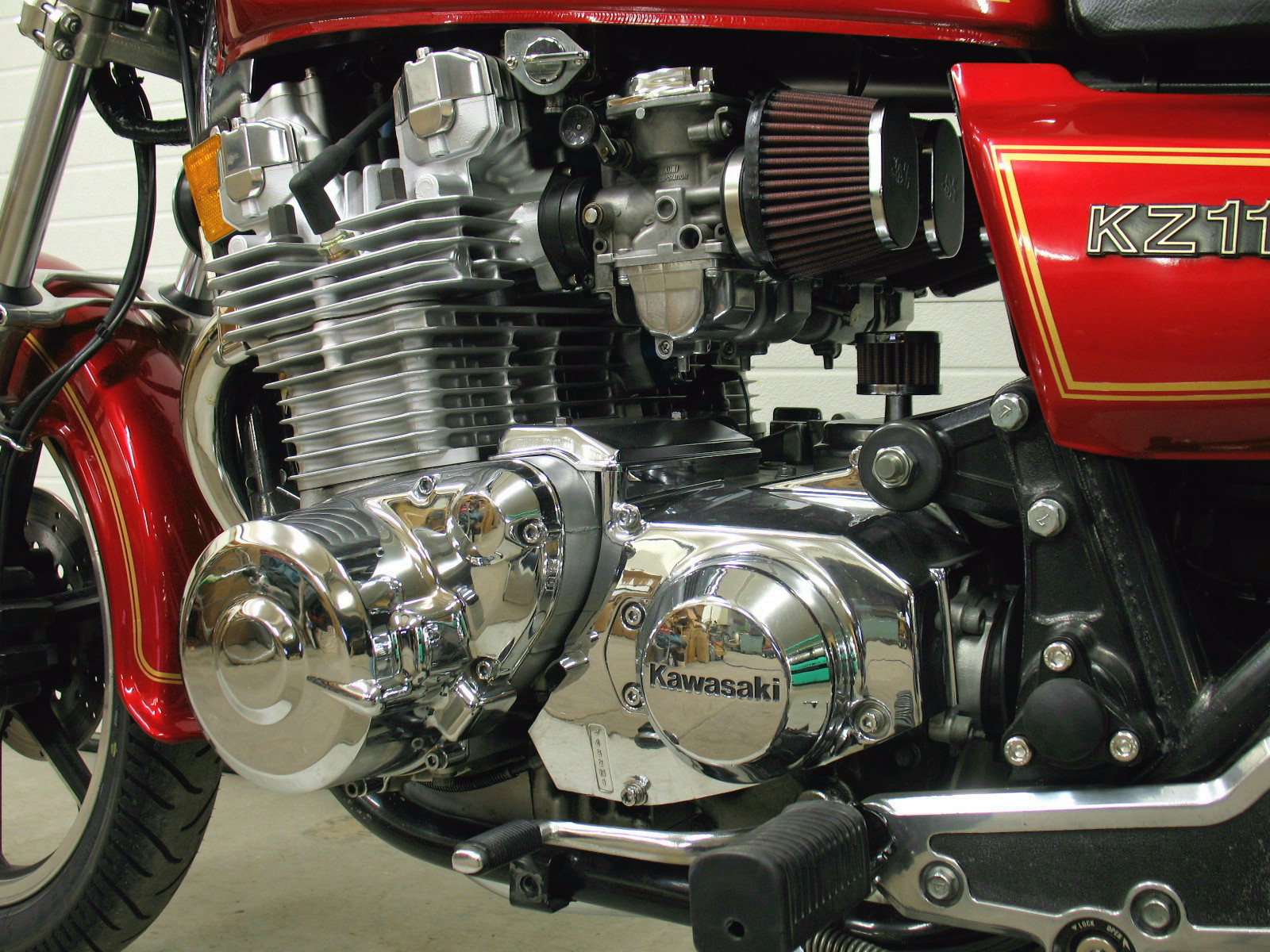

Ran with the pods two years ago. It was fun, but I'm back with the air box for now.
The breather cover hole was bored for the .5" diameter filter tube to friction-fit inside, thus preventing oil from escaping while draining back to the motor.
