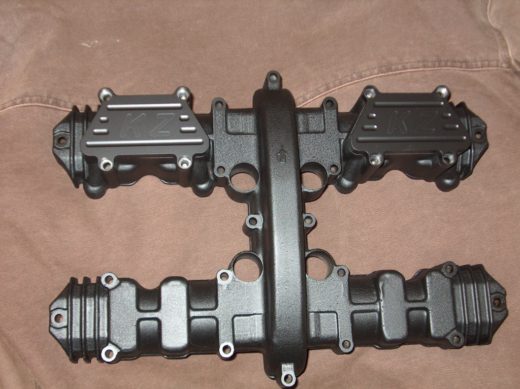

What's your plans on venting or capping the emissions aka butterfly's on the top of the motor..?

www.kzzone.com/
Last edit: 25 Feb 2014 14:58 by peter1958. Reason: add picture
