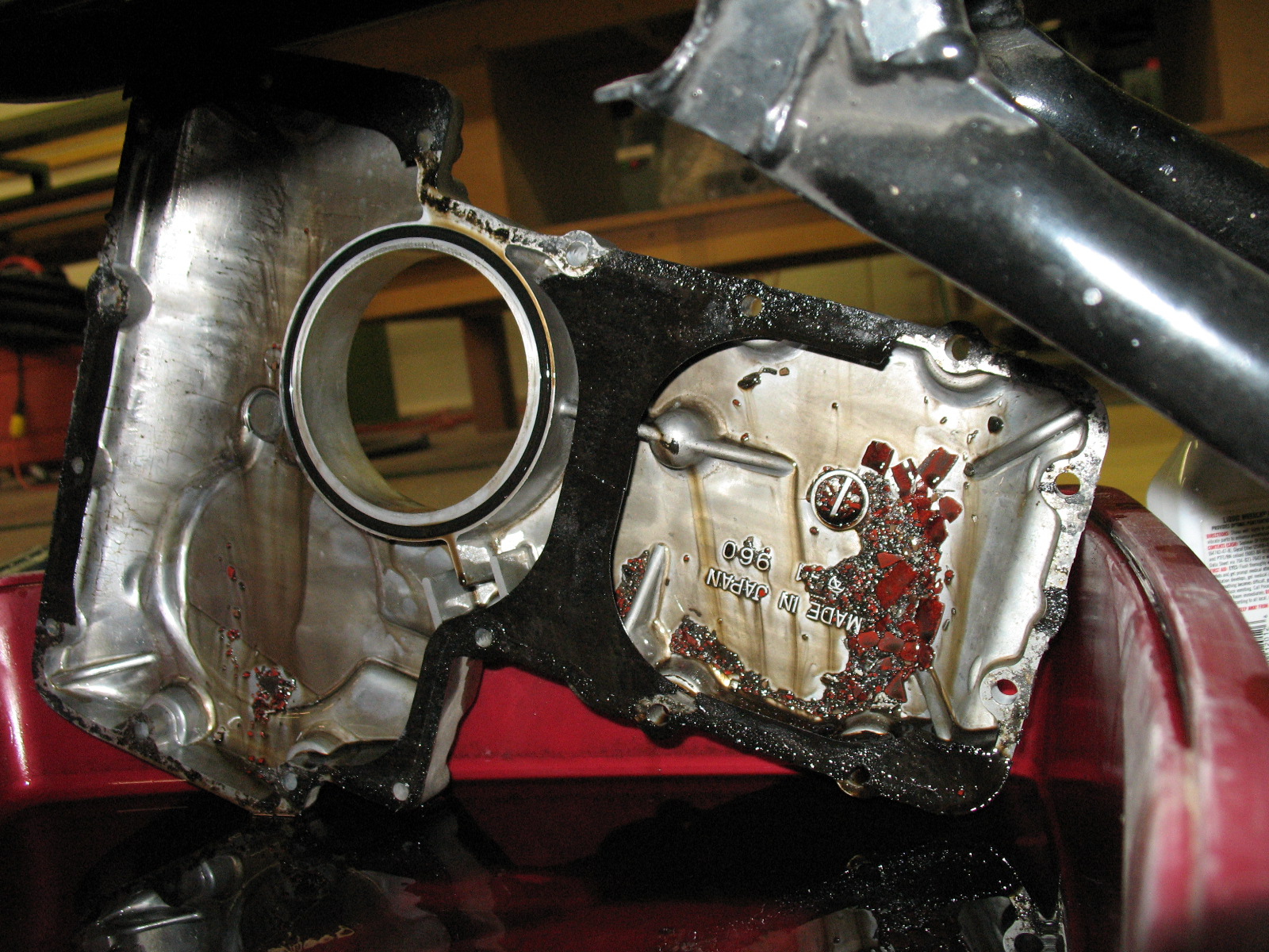

13 Feb 2014 08:33 - 14 Feb 2014 10:39Chris_Z1100 wrote: Thanks Daveo! felt a bit of a rattle through the alternator cover. Took it off and one of the magnets has cracked. Not sure how though... Would the broken magnet be all that is rattling? It seems pretty small to be making so much noise.
See: www.kzrider.com/forum/2-engine/540846-oh-brother#540846http://
If the magnet piece is loose, it is possible. Post a close-up picture of the broken magnet if you can.
This is likely where the magnet fragments have gone. Pic taken 9/05/10
