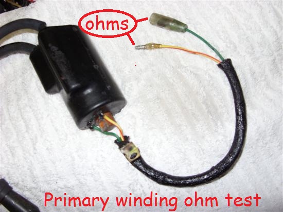

nessism is talking about the primary resistance... that is the low voltage resistance not the high voltage side. The ohmic value of your new coils needs to match the value of your originals... about 3 ohms IIRC

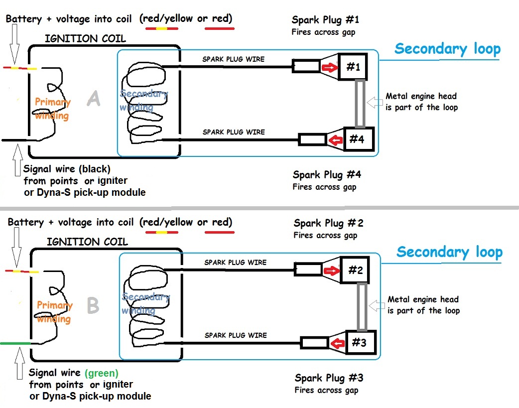

With the stock ignition, the ohms resistance of replacement coils should match the ohms resistance of the stock coils.
Resistance of stock coils is shown in the Kawasaki Factory Service Manual, among other sources for such information.
It's okay to use copper core plug wires with non-resistor plug caps and with non-R plugs, all simultaneously. Which minimizes resistance in the secondary loop, But leaves no resistance component to subdue radio frequency interference.
As already noted, if resistance is desired in the secondary loop, only ONE resistance component should be fitted (i.e., suppression plugs wires OR resistor plug caps OR "R" spark plugs). But don't combine more than one of these resistance components.
