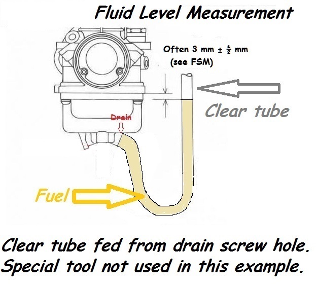

Kenneth Brisco wrote: . . . When I pulled that plug it had fuel though that's what's weird . . . .
Remember to assure correct fuel level by performing the clear tube test.
A too high fuel level causes over-rich mixture in an otherwise perfect carb.
Good Fortune! :)

What is the clear tube test? Never heard of it?
Also my petcock only has a on, prime, and reserve position so fuel is free flowing to the carbs and can't shut off completely. So I'm pretty sure the carbs are constantly flooded.
