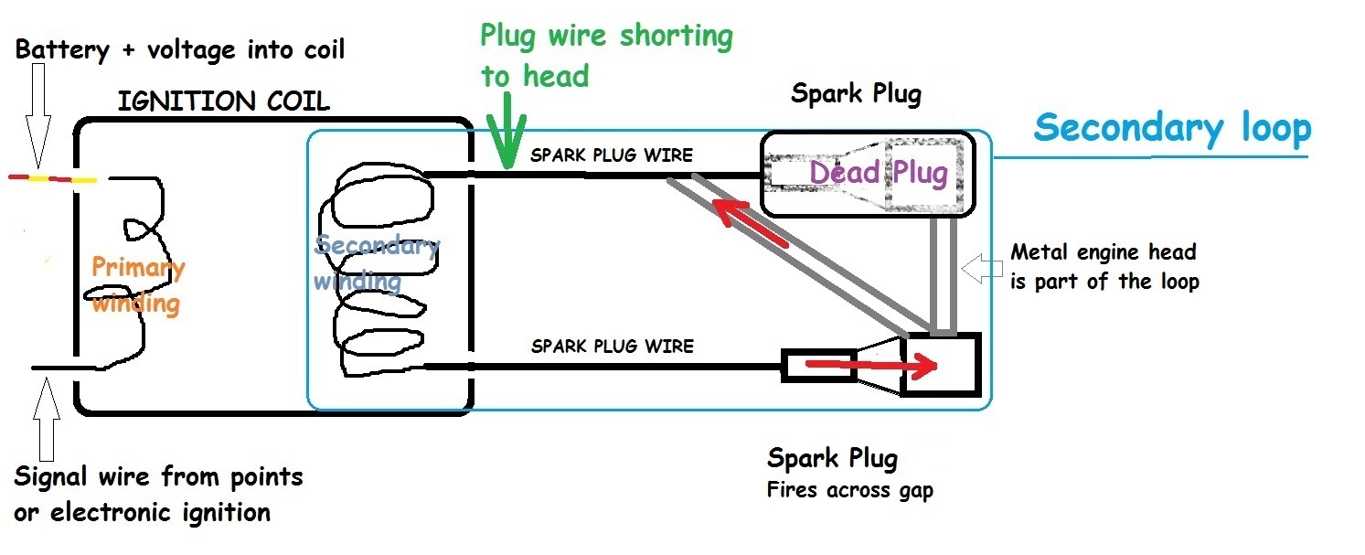

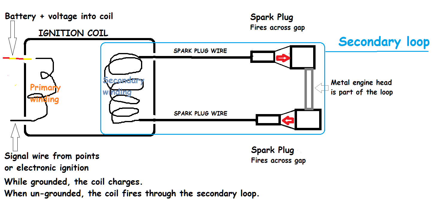

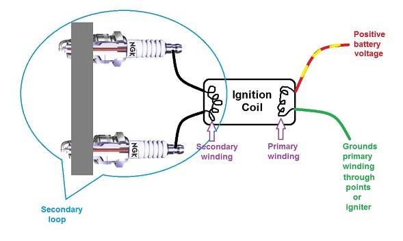

26 Nov 2013 18:24 - 27 Nov 2013 09:30 #614155
by Patton
Replied by Patton on topic KZ440 D4 LTD Engine Woes
These illustrations may help understand "firing" through the "secondary loop."
When viewing spark quality with plugs removed and held grounded against the engine head while spinning over the engine, must watch very closely to see which way each spark jumps across the tip. :lol: :lol: :lol:
I don't know of anybody other than Old Man Rock and loudhvx, and maybe bountyhunter, that are actually able to do this.

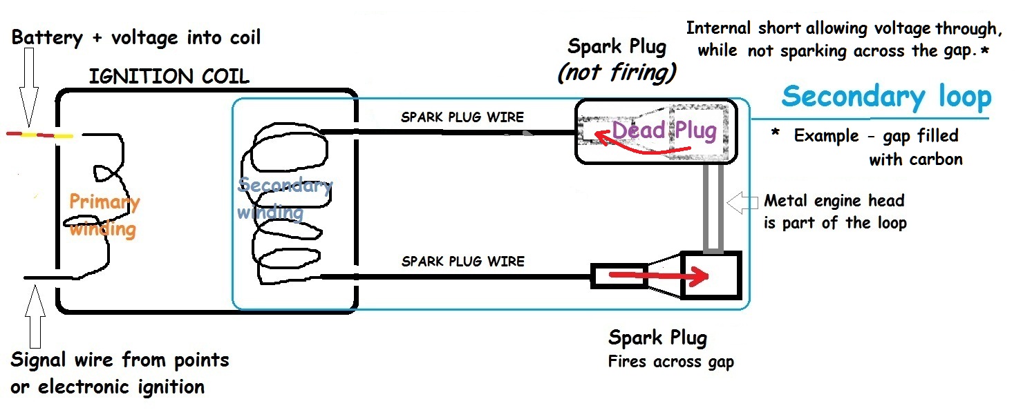

26 Nov 2013 18:55 - 26 Nov 2013 18:57 #614159
by Patton
If there's a break anywhere in the secondary loop, neither spark plug will fire.
A break may be anywhere, such as:
• Inside the ignition coil (broken or shorted wire in the secondary winding;
• Poor connection of a plug wire to the coil tower;
• Plug wire that's broken inside or shorting through the insulation;
• Poor connection of a plug wire to the cap;
• Defective plug cap;
• Poor connection of cap to plug;
• Bad spark plug.
If one plug is firing while the other plug isn't firing, current may be passing through the non-firing plug, or voltage could be by-passing the non-firing plug through a plug wire that's shorting to the engine head.
• Bad spark plug.
Last edit: 26 Nov 2013 18:57 by Patton.

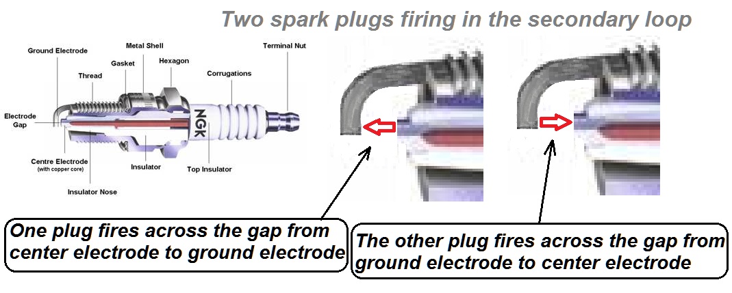

26 Nov 2013 19:12 - 26 Nov 2013 19:13 #614161
by Patton
About the dreaded "Wasted Spark."
The "wasted spark system" means that when both plugs fire simultaneously, one of them is doing its expected job of igniting combustion inside a cylinder filled with compressed fuel mixture. But the other simultaneously "firing" plug is wasting its spark during the other cylinder's exhaust stroke.
While both pistons rise and fall together, they are 360° apart in their respective four stroke cycles of Intake - Compression - Power - Exhaust.
Last edit: 26 Nov 2013 19:13 by Patton.
