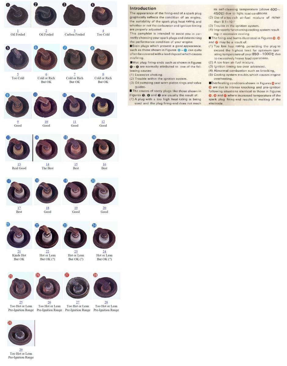

Okay so right plug looks like number 20 and my left plug looks like number 3 . You can really smell the gas on left plug . Also my plugs are silver . Ive seen the non-resistor b6es is copper colored . Is this an issue? Maybe I should run a b6ES in left side and keep the right at b7es . I will probably look into new plug caps too just incase its a lack of power transfer .

#20 about right, #3 is rich condition....
Possibly jetting is off, carb sync, pilot/slow/needle jet is clogged/not adjusted correctly, spark plug wire and cap etc....
If one side is good then the plugs themselves most likely are NOT your problem....
What you should be looking for in base ring & strap conditions.... As for TAN colored insulator, never happens here in AZ due to ethanol gas we have here, possibly in your area pending GAS qualities.... Charcoal gray is about it... Just insure no pre-detonation (metal ball/particles) is occurring on the insulators.
Strap 50/50...?
Base ring 360 light carbon...?

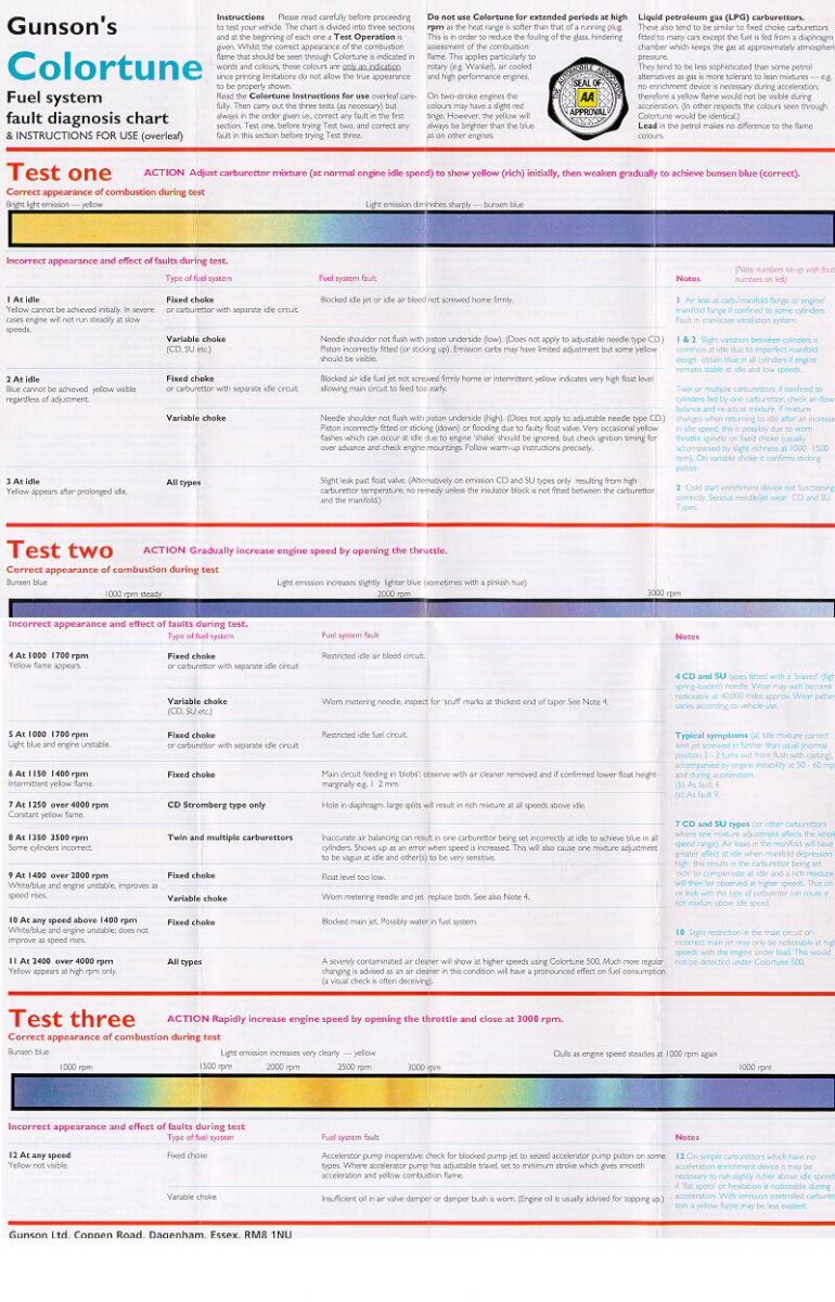

The associated video clip I recorded while learning carb tuning was extremely helpful.
While listening to the clip, at the beginning where it's over yellow (rich) and starts to go to bunson burner blue... pay close attention to the rpm sound.... you'll here where the rpm increases!
This is what the old timers mean when "Tuning by ear"... AH-FREAKIN-SO!!!!
I get it now what that (tuning by ear) truly meant....
There's actually 3 tests to perform in the tuning chart...
1) @ idle
2) Slow ramp to 3500rpm
3) Quick blip of the throttle....
It's in the chart I provided in the KZR filebase...
