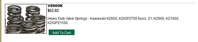

There is a spec for the installed height, as well as a minimum distance from the valve tip to the retainer groove. I wouldn't take off .020" that's way to much. You probably only need .004-.006" to get you set up.
You need the Factory Service Manual, it will have all of the info on it. ;)
I don't know which springs you bought, but APE sells a good set of replacements with a bit more pressure. Might save the valves from a bad down shift, or another Gixer rider.
ape-store.com/shopsite/page38.html

Thanks Motor head. I happen to have a 1st addition of the Z1 service manual from Kawasaki. I'll have to sped some more time in there and find those specs. The manual I gave the machine shop guy didn't have it. The real shop manual has been bought since then.
The springs are good after market dual springs which high lift cams can be used and could very well be APE. Tim
