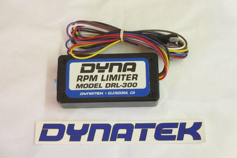

Had the same problem but my cause of bent valves was missing a gear change (and weak valve springs), that's why I have a dyna rev limiter. The scooter (Z1R) easily revs to 10,000rpm+ under power, so I set my rev limiter to 10,500rpm. I have also noticed that above 10,000rpm the shift is harder because I still have the original Z1000 crank which at these revs has a bad flywheel effect so I might turn the limiter to 9,500 to save my motor from the idiot turning the throttle.
I think that if you have correct valve timing and keep the cam chain tensioned and have good valve springs these engines should take an accidental 11,000rpm.

My C14 Rev limiter comes on at 11K with a red line of 10,500. It hard to watch the TAC on the C14 because the needle swing is so much faster than the 900's in the low gears.
The other thing I know is if the valve springs get old a weak, a missed shift could result I bent valves.

Also.....never leave home without it, it's cheap insurance:
