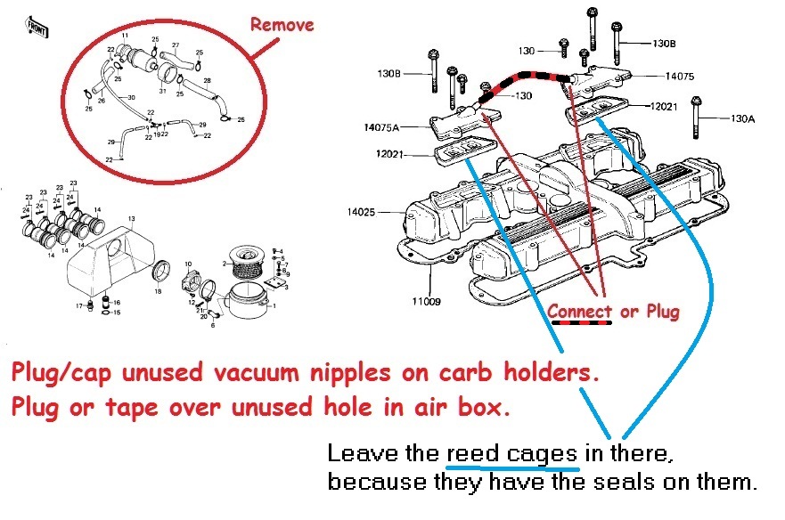

They make a small breather that will attach to the nipple on the engine cover also. I run a breather hose from that cover up and back to rear of bike. If you route it under bike, try to route it so if any oil does enter that hose, it doesn't end up under rear tire. The upper hose was just part of the emission system and will run fine without it. Some will use where it attaches to valve cover as breathers for the engine to relieve any pressure build-up or you can run a hose between the two covers to seal it off. They make solid covers to replace the stock one for some bikes but not sure for the 750.

Breather cap remains fully intact without removing anything except the stock rubber hose that runs from the breather cap outlet nipple to the airbox.
