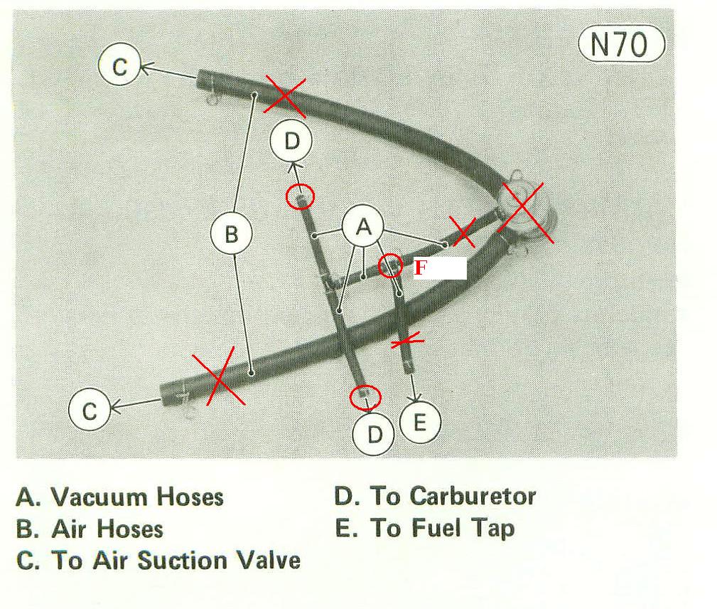

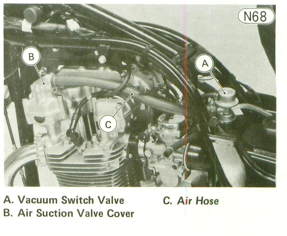

You will have to right click and "Save as" when you get to that link (note which directory you save the file so you can have access it). It will take about 10 min to download. This service manual has a supplement for the 81 CSR towards the back which should help you out with the carbs. That is where I got the above picture from.

That picture looks just like the old engine, the 1982. The 1979 engine doesn't have the vent port on the valve cover. So there is no where to hook up the vaccum switching valve. We don't even have it hooked up right now at all to the new engine.

OK, so I hope I don't lead you in the wrong direction. But the red X's in the picture above show what has been eliminated do to the engine swap. But it if you look at the picture, it looks to me like the once I circled in red is what you should have left. The ends marked as 'D' should go to each carburetor and the one I marked in red as 'F' should go to your petcock. As mentioned, I have never owned a KZ750 twin so its hard for me to be 100% certain. Maybe somebody like bounty hunter can confirm all this for you. Download that service manual that I gave the link for ( bublicpucket.s3.amazonaws.com/Manuals/ka...llwith80and81sup.pdf ). It will seem like its stuck once you get to the site. But point your mouse where the body of the text should be then right click and choose "Save page as" to a local directory you can access. That should help you out.
