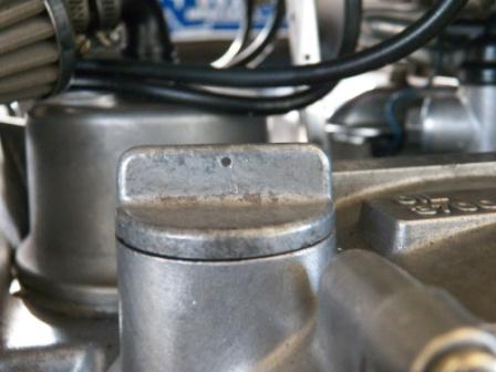

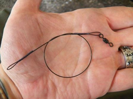

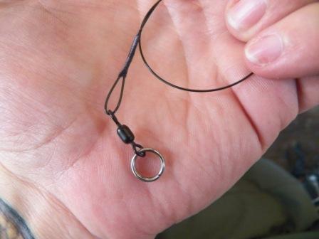

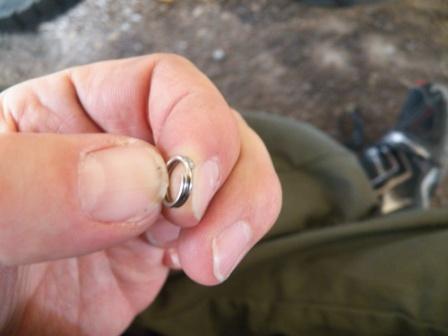

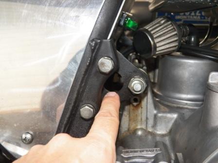

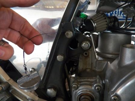

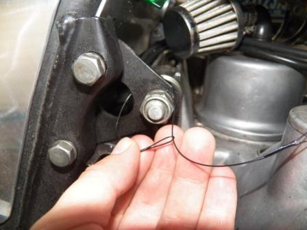

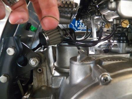

Here is my solution. A tethered oil cap, never to be lost again.
materials used:
1- 9" stainless steel nylon coated leader
1- #6 Stainless steel split ring
Step 1- Drill hole in oil cap i used 5/32" bit
Step 2- Connect split ring to swivel end of leader
Step 3- Find someplace to tether to(this will determine tether length)
Step 4- Run the swivel end back through the pre-fashioned loop.
Step 5- Connect split ring to oil cap
Finished
Hope this helps. Enjoy!

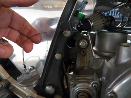

materials used:
Finished

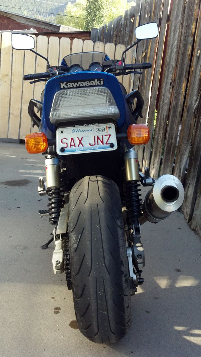

AND.....What a crazy coincidence! As you may recall, this is the very thing that happened to SaxJonz on our way into Jackson, WY to meet YOU!
Remember This?!
Remember This?!

07 Aug 2013 00:07Yes I had to laugh when it happened to me. I figured two guys with in 48 hours it must be a some what common issue.

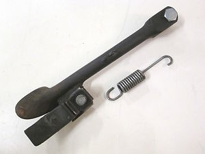

Beats me why all side stands aren't equipped with the rubber extension (used by Honda) designed to disengage a deployed stand while riding instead of allowing it to pole vault the bike.

07 Aug 2013 01:08Is that what that rubber does? Thanks for that info, as I've been wondering for 40yrs nearly.
