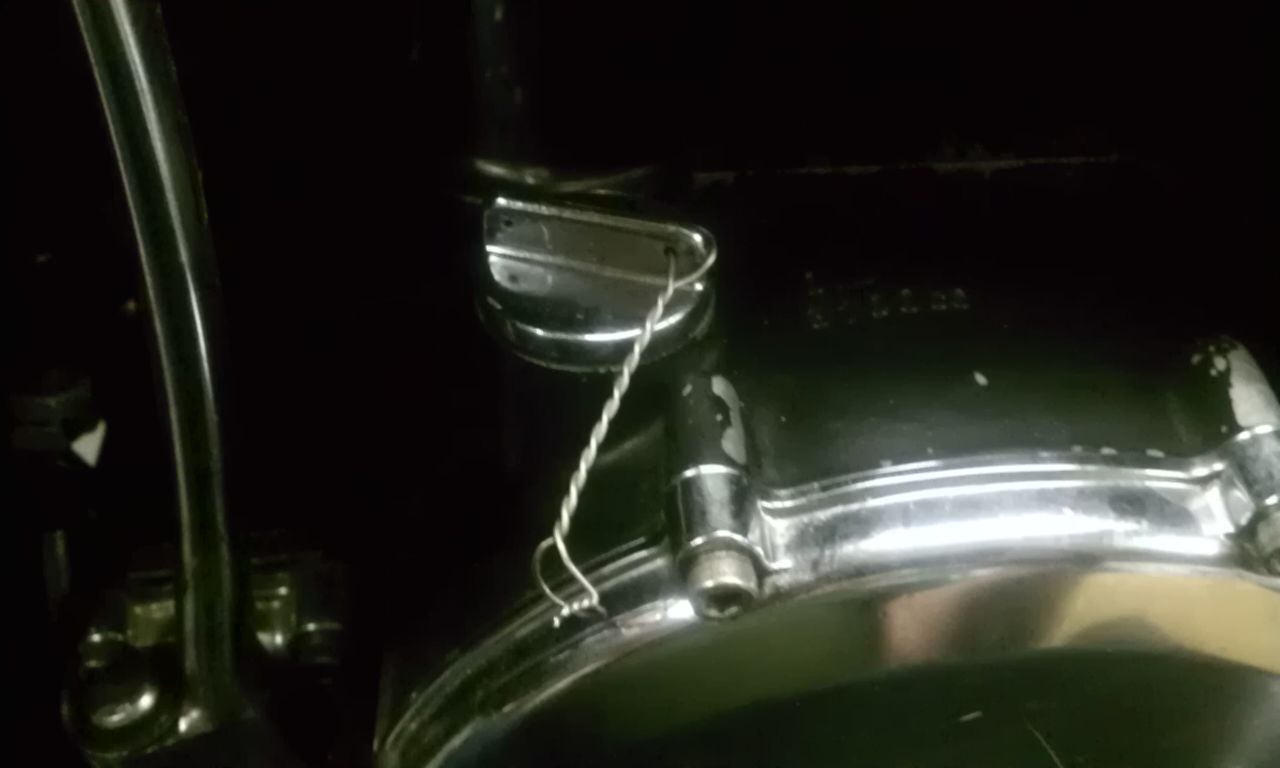

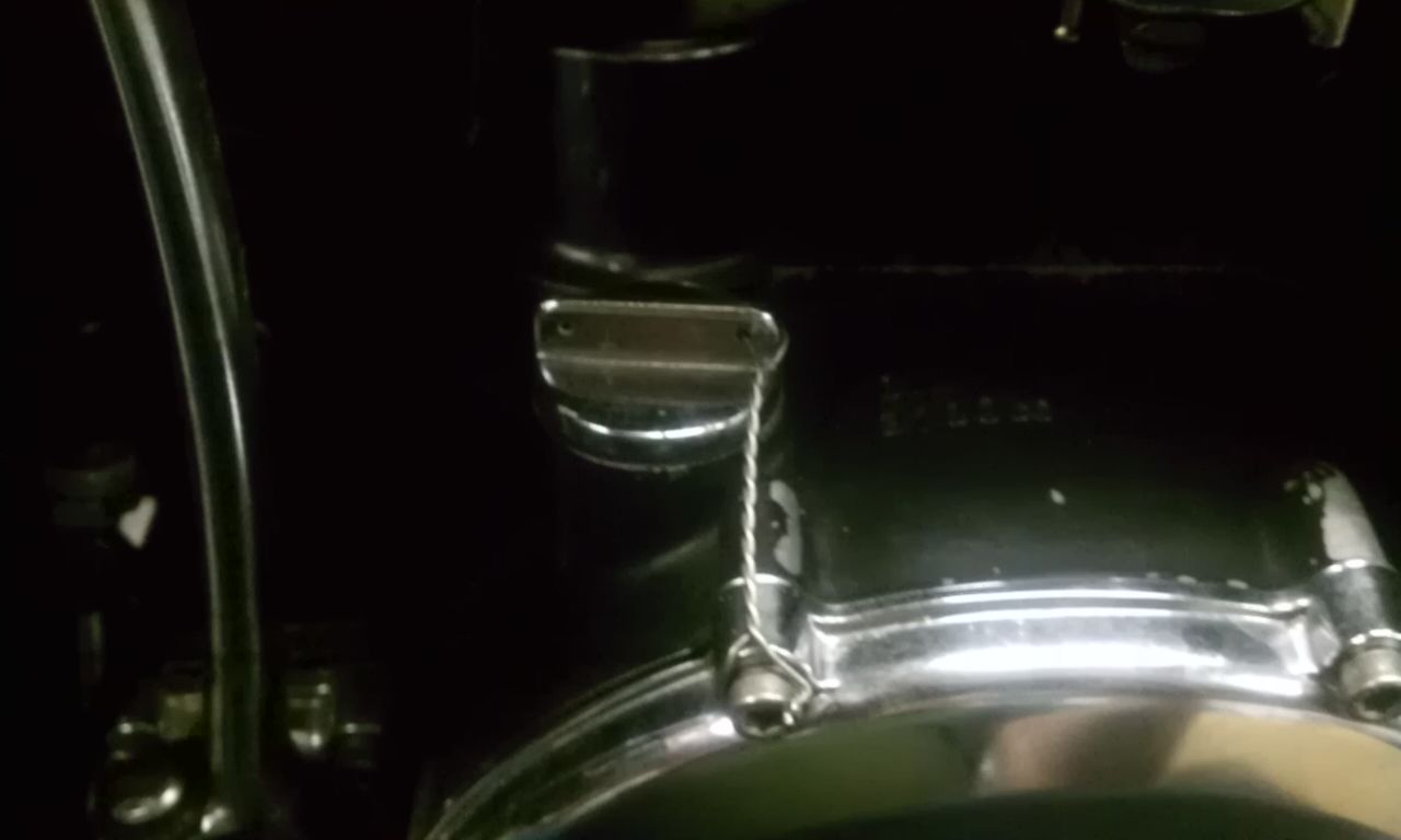

Here's my solution. The cap isn't twisted on super tight. I can tighten it a smidgen to release the safety wire from the cover bolt head. Then unscrew it. Reverse to put it back on. It can't vibrate on tighter and the wire keeps it from vibrating looser. On an off with no tools. It's been working for 3 years.
The only time it ran with the cap off is when I first started it after the overhaul. I was so pumped to hear it run I filled it with oil and pushed the button. It fired almost immediately and gave me a pretty good oil bath. :woohoo: :pinch: :S
