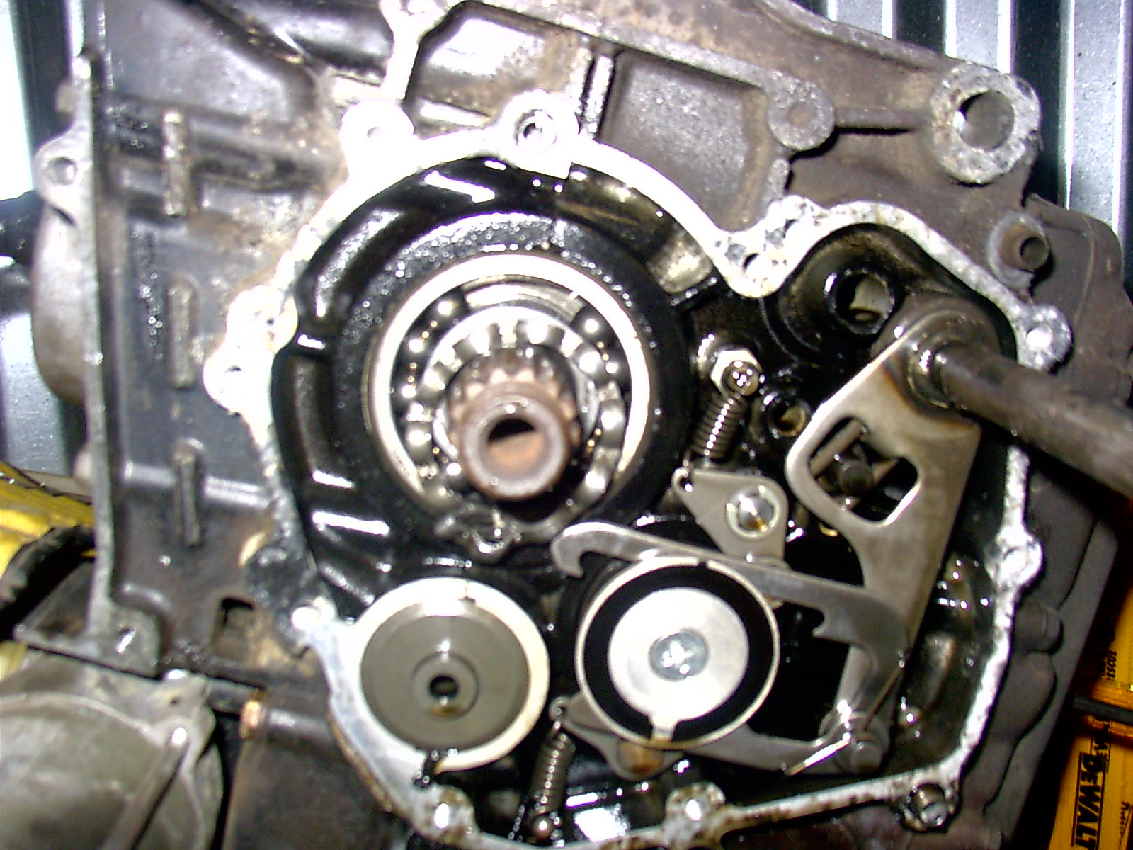

any kz/z1 head from a 900/1000 will fit.
also pull the cover behind your counter shaft sprocket.make sure the out put shaft bearing is not broken.i had the one in my 1980 z1r crack around the circlip groove and the cage came off letting the bearings"stack"up on one another which allowed enough slack for the output shaft to jump around in first and second.
i have seen another 78 z1r with the same problem.
