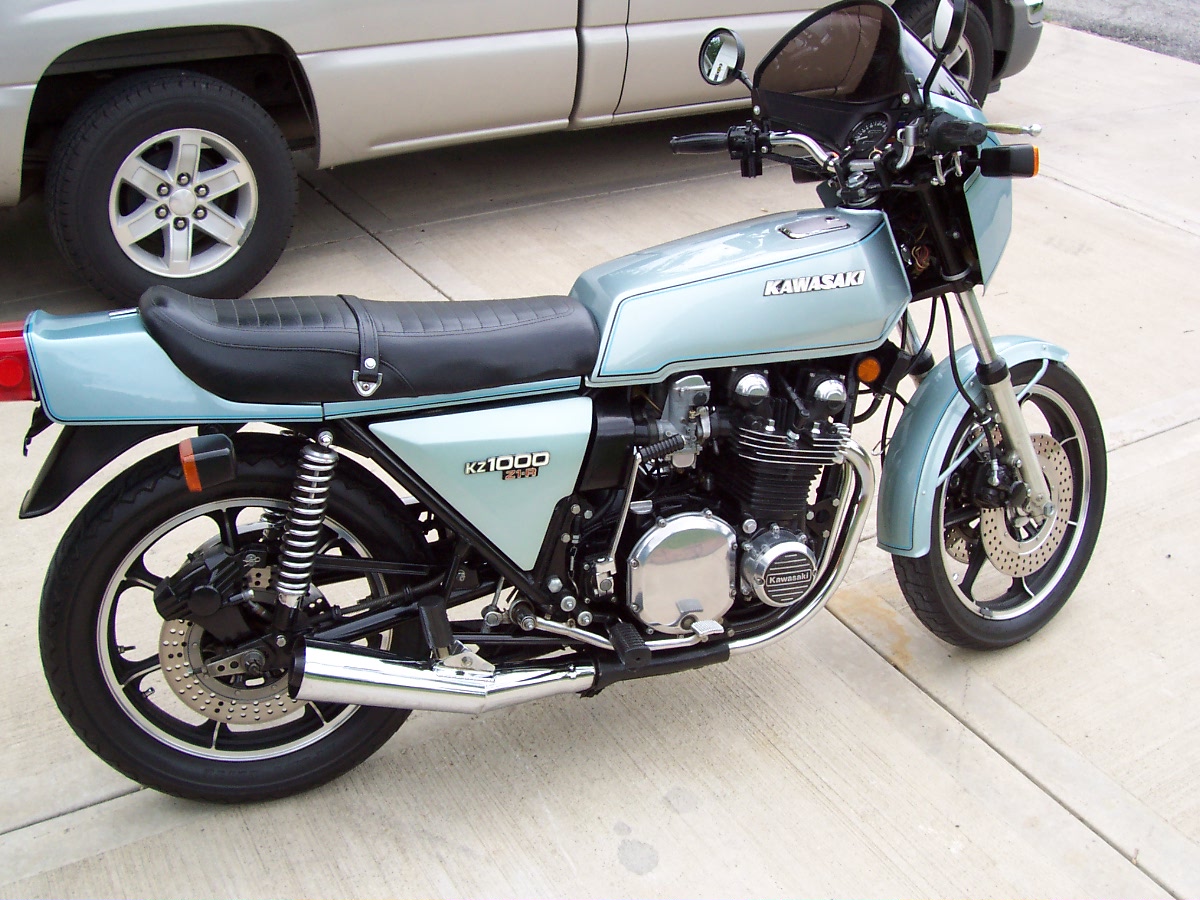

30 Jun 2013 19:08
good lookin bike but,,,,,bought it for under 10K wow
brings the old saying in mind a fool and his money soon parted
Tell him can have this for 10k
