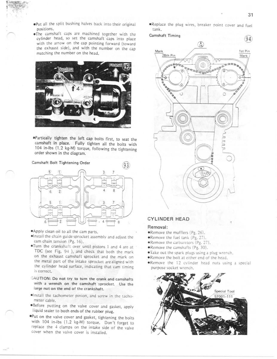

I hate to bump this old thread but it's the only one I could find with the cam torquing sequence like my manual.
In that manual page above showing the sequence, which way is the front / exhaust side ? There are no arrows showing front or anything.
Are those things sticking out suppose to be carburetor mounts or exhaust connections ??
Just want to be absolutely sure before torquing my cam bearings.

Re: cam caps
04 Dec 2018 17:26
Look at the cam caps on your engine and look at the picture of the cam caps in the manual under the “Camshaft Cap Tightening Order” section. Notice that each of the caps has an arrow and a number molded into it.
When installing the caps all the arrows need to face forward. The numbers refer to the location of each cap when properly mounted on the camshafts. The 4 exhaust cam caps are marked 1 through 4. As you sit on the bike you mount them starting with #1 on the far left side of the engine with #4 ending on the far right side of the engine. The 4 intake cam caps are marked 5 through 8. You mount them starting with #5 on the far left side of the engine with #8 ending on the far right side of the engine.
If you look at the drawing in the Kawasaki Service Manual this should all become easy to understand. Ed

04 Dec 2018 17:33
Thanks for the reply Ed.
So looking at that picture above. The top of the picture is toward the front of the bike ?
The carburetors would be mounted at the bottom of the picture ?
I have a kz1000 j engine
