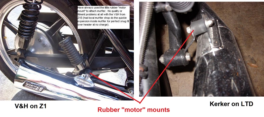

Hey! I have never written anything on a forum before, but here goes: I have an A5 77 KZ900 that presently has old beat-up 4 into 2 Jardine pipes on it. I found some nice pipes designed to go on a 77 KZ1000. I know that at the engine these mount up. But back by the foot-pegs, the mounts look way different; with the 1000's mount being a bolt that comes out of the middle of the pipe. Is there an adapter for this. I don't have any other old Kawies to look at.

KRJr wrote: Hey! I have never written anything on a forum before, but here goes: I have an A5 77 KZ900 that presently has old beat-up 4 into 2 Jardine pipes on it. I found some nice pipes designed to go on a 77 KZ1000. I know that at the engine these mount up. But back by the foot-pegs, the mounts look way different; with the 1000's mount being a bolt that comes out of the middle of the pipe. Is there an adapter for this. I don't have any other old Kawies to look at.
Hello, KRJr, and WELCOME TO KZr! :cheer:
A simple bracket may be fabricated from the muffler to the frame.
I include a small rubber motor mount to isolate exhaust vibration.
Good Fortune! :)

Patton: Thank for the very clear pictures. It sure looks good on your bike.
