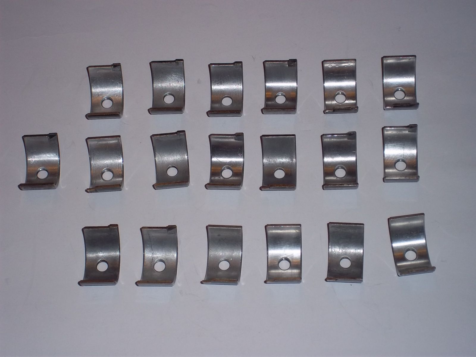

Re: cam bearings..
15 Apr 2013 11:08
Nice deal! $1.10 to your door. Someone got a good deal.
19 for $17 bucks.
cgi.ebay.com/ws/eBayISAPI.dll?ViewItem&r...8434009#ht_504wt_721
19 for $17 bucks.
