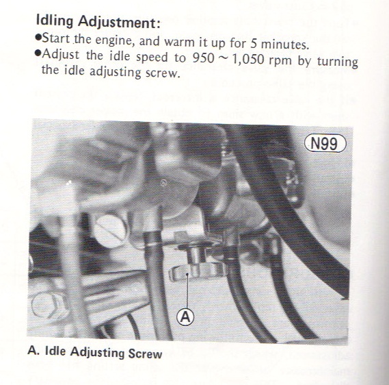

On some models, the idle adjustment screw is accessed from the bottom of the carbs.

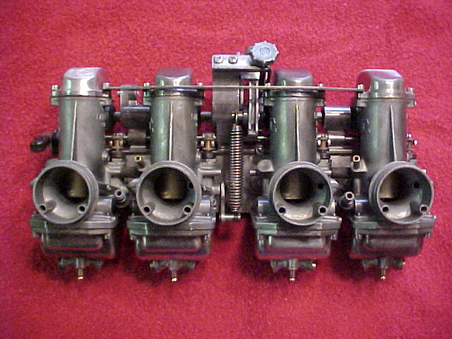

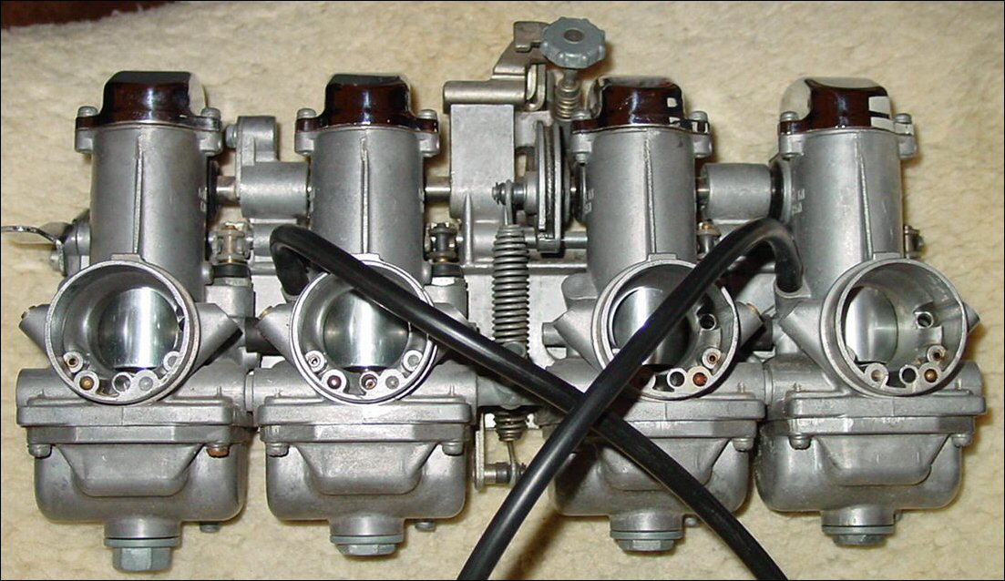

Hey, Ed -- No telling what was done to the bike during the 20 years before stored in uncle's garage. :unsure:
When belatedly informed that the carbs at hand are smoothbores, or 26's from a KZ900 or '77 KZ1000, it'll all be okay. :lol:

and Patton in the picture of the idle screw down on the bottom what kind of carbs is that because that
is just like mine and I don't know how to identify what carbs I have
79 KZ1000 ST

jer09521 wrote: and Patton in the picture of the idle screw down on the bottom what kind of carbs is that because that is just like mine and I don't know how to identify what carbs I have
Mikuni VM28SS (26mm bore with manual slide) on stock 1978 KZ1000-A3 (Mark II chain drive) and stock KZ1000-D2 (Z1R-II cafe racer).
Picture is from the official Kawasaki KZ1000 Motorcycle Service Manual covering 1977 KZ1000-A1, 1978 KZ1000-A2, 1979 KZ1000-A3 (A1, A2 and A3 being standard models) and 1978 KZ1000-D1 and 1979 KZ1000-D2 (D1 and D2 being cafe racer models).
This particular manual doesn't include information about the 1979 shaft drive KZ1000-E1 model, which I believe has its own separate manual.
There's a link in my signature for help with navigating kawasaki.com and seeing parts diagrams and other information pertaining to the KZ1000-E1. Also see KZrider FILEBASE link at top right of screen.
