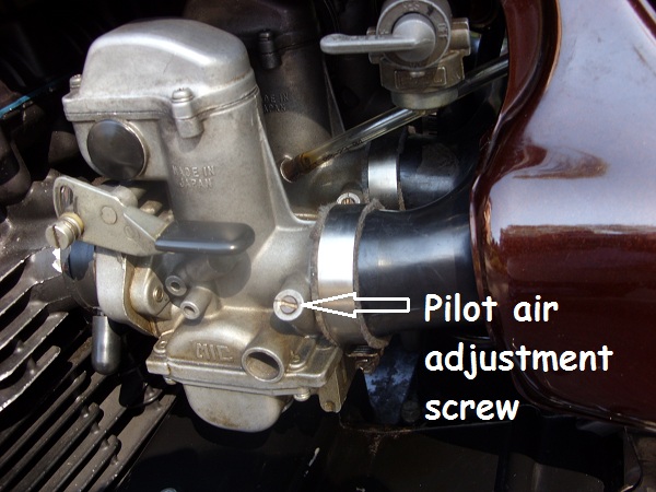

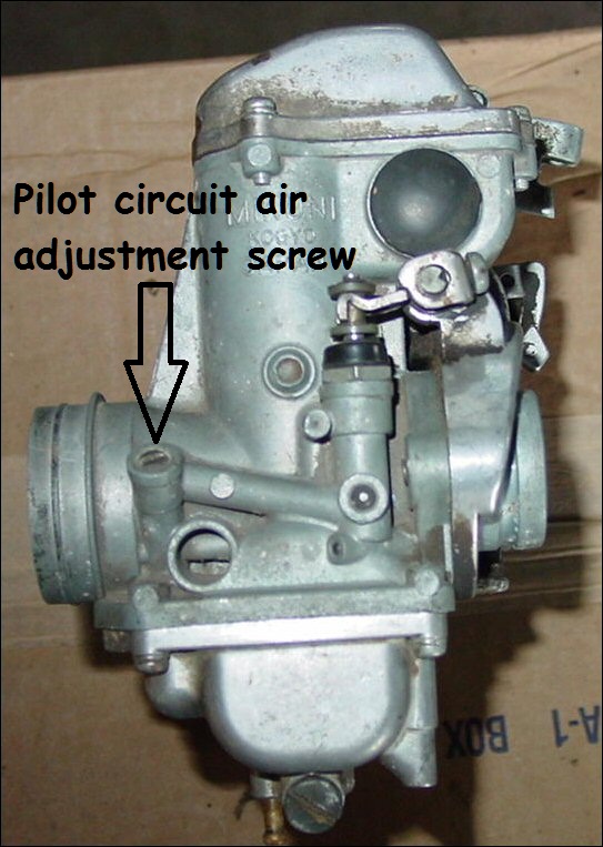

Do each of the carbs at hand have a pilot screw located as illustrated in the following pics?

and is number 1 the air adjustment screw from the previous couple of pictures?

24 Feb 2013 12:40 - 24 Feb 2013 12:43Yes.jer09521 wrote: and is number 1 the air adjustment screw from the previous couple of pictures?
Also, the pilot jet (number 4) should be cleaned while it's removed and in hand.
It's okay to use a piece of wire to gently push through the pilot jet holes in order to help clean out any encrustation.
Should be able to hold the pilot jet up to the light and look through either end, seeing the small clear round orifice.
Keep the same float needles with their same float seats -- do not mix and match the needles and seats.
Keep the same float with the same carb.
While carbs are on the work-bench, would also do a proper bench sync, leaving sufficient idle screw thread remaining to further lower the carb slides after the carbs are re-installed onto the bike.
