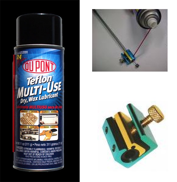

My clutch cable broke last week and i just recieved my new one from motion pro. Do i need to lube my new one and if so what do i use

There are special cable lubing kits made for the clutch and throttle cables such as the one Patton shows above. I have never used them, but I would bet they work very well.
