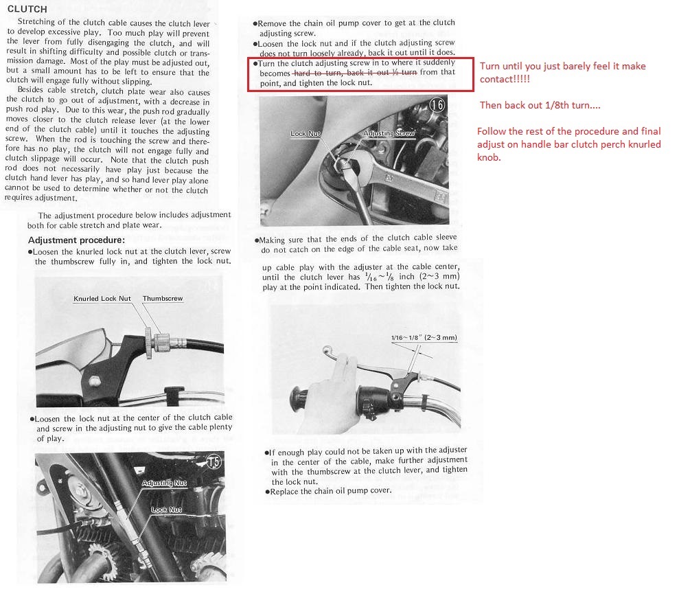

- Old Man Rock
- Posts: 6224
- Thanks: 225
Re: Clutch problem
17 Feb 2013 22:35 - 17 Feb 2013 22:38
Assuming all other components/rod/bearing etc... to working specifications...
Try this for worked on my KZ900 with all new components....
See RED text for the OEM Manual procedure did not work in my build either.!
