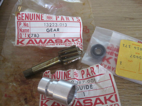

In the Parts Fiche I don't see the usual screw and metal tab that secures it. But it shows the O-ring around the guide. It must come out like the others, but the part says its for the 750 twin Only. So it may have a different way to retain it. If you get the Guide to start coming out, use a magnet at the end of the pinion to hold onto it while removing the Guide, or a small pair of Needle Nose. That way the Pinion won't fall into the top of the motor, making the valve cover removal next on your list. Of course maybe its time to check the valves anyway, and removing the valve cover would ease the removal of the guide and pinion.

I found this picture on Feebay, of the Guide. I see a O-ring groove and nothing else for retention. No snap ring groove or notch for the usual set up with the screw and metal tab. So does it say any removal procedure in the Twin manual??
