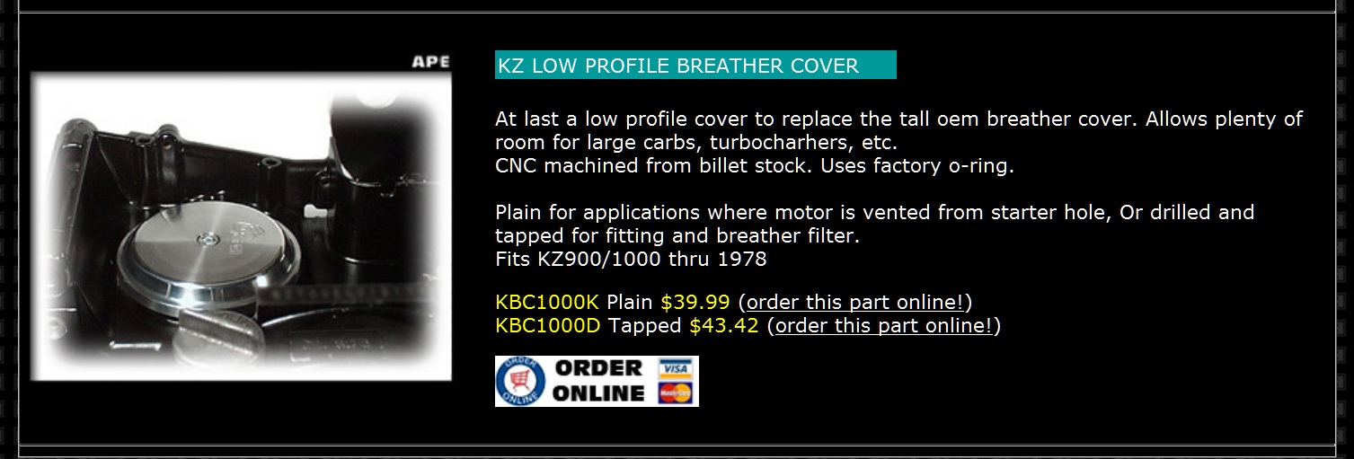

Re: Swap short breather cover for a tall one?
20 Nov 2012 18:34 - 20 Nov 2012 18:42
Click >
a really nice billet low profile cover
And tapped version also available at Z1E.
Click > www.z1enterprises.com/ItemDetails.aspx?i...d%29&item=APKBC1000D

I run an APE cover on my turbo bike - it gives much more clearance for the turbo and associated plumbing. However, inside the tall tower are baffles - and these help collect oil thrown up from the transmission. I have a catch bottle tucked down by the swingarm, and it does collect a small amount of oil - not a massive amount, but noticeably more than when I ran the baffled tower.

Thanks. I am not allowed to do that because I am a paid advertiser.
