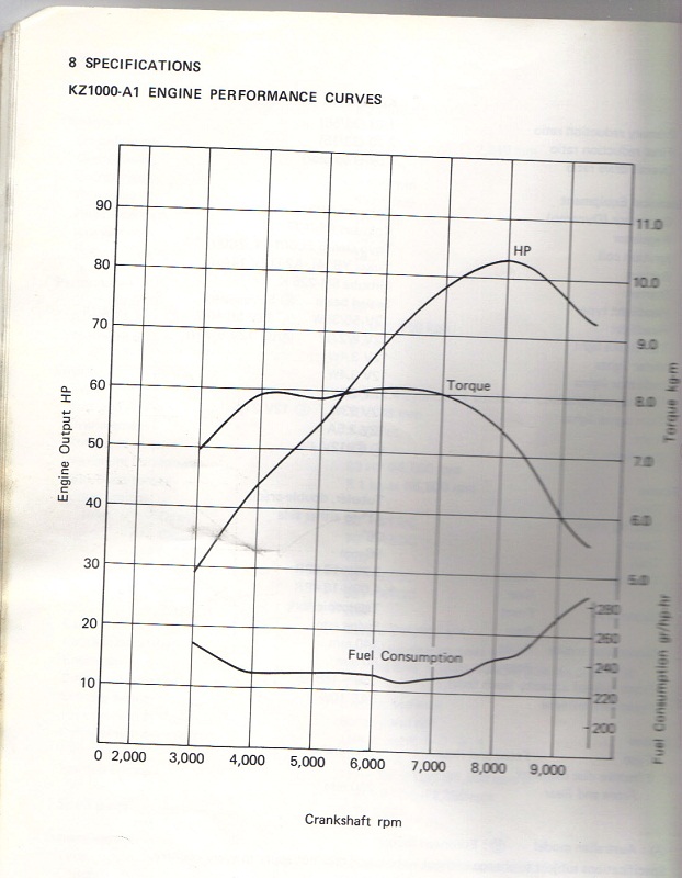

I've tried searching this site and also Google to find the factory spec torque curve for my motor. All I see are modified engine results or rear-wheel numbers that vary depending on who did the test.
Please point me to the real deal.
The reason I'm looking is, I seem to have a flat spot between 4,000 and 5,000 RPM. Pulls hard on both sides of that range. Normal?

Re: Stock torque curve for 1997 KZ1000P?
23 Nov 2012 00:58 - 23 Nov 2012 01:01
Mucho thanks, Patton!
So, the torque curve is basically flat from 4,000 to 7,000 RPM, but power output is almost linear from 3,000 to 8,000 RPM. I shouldn't be able to feel any "gaps" during acceleration. Guess I will have to figure out what's going on.
Cheers,
Cheers,
