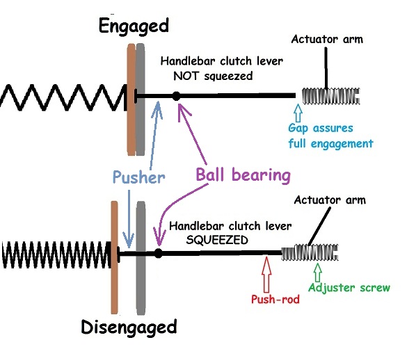

Recalling an earlier thread with history of clutch issues, and one post about where reversing the push-rod improved clutch performance -- which might indicate a bent push-rod.
Has the routine clutch push-rod adjustment been performed? Specified gap setting?
And the push-rod in good condition, clean, and not sticking in its channel?
An otherwise perfect clutch will slip when the push rod isn't properly adjusted to provide the specified gap between the actuator assembly and the push-rod.

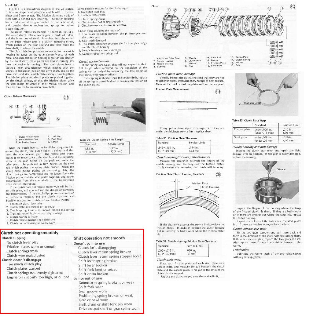

Stock kawasaki clutches are the best depending on who you ask.
Pull it apart and make sure your steel discs are all flat on a piece of glass,if you have access to a glass beading cabinet go ahead and blast the steel plates.
Measure your springs if theyre good reuse them,if not get stock replacement springs.
Install a new set of factory fiber discs after soaking them in good oil for a few hrs.

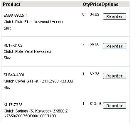

Barnett or APE kits, nothing wrong with them, superior grip but tiring on the hands for daily street use...
Z1 has everything you need for OEM steel & friction plates and springs..
Do yourself a favor and just replace all for ~ $150 and be done with it...
