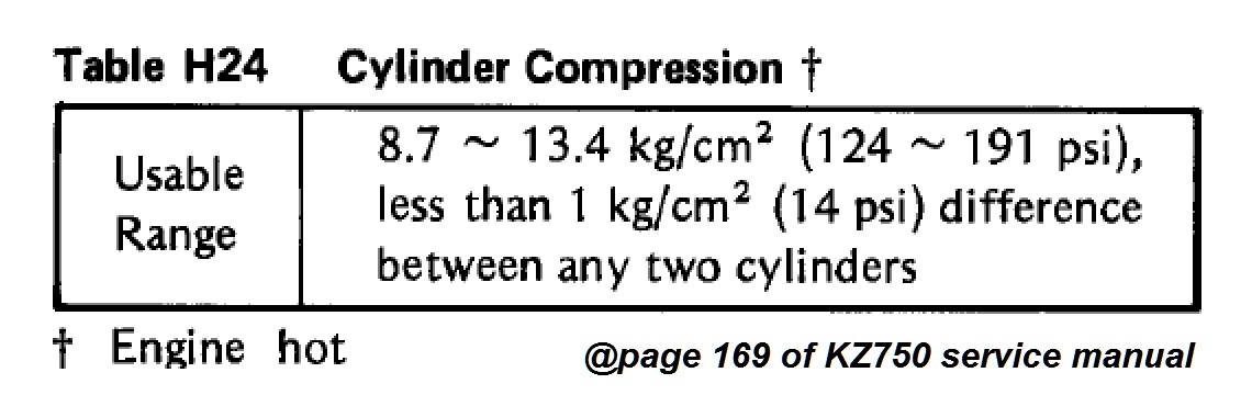

Compression figures are shown on page 169 in the KZ750 manual downloadable via this link:
kz.bike-night.com/media/GPz750-full.pdf
But am uncertain whether applicable to the particular bike at hand.

well, the link indicates it's for a GPz750, so it should be the same. Spectres were the same engine, but didn't get the porting the GPz's got, and had different carbs. At least that's what I've read. Same engine for sure. So it's good to see that my compression is at least in their range, and just the one cylinder outside of the 14 psi difference.
