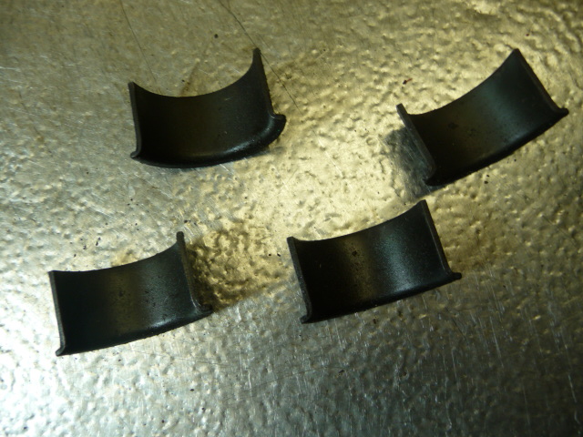

Are the half-collars missing?

where do you get split colars?

andyn4188 wrote: where do you get split colars?
From people with aftermarket systems that don't use them....
I don't know if I still have mine?

Exhaust system may be stock, and if so the split collar part number is 92027-1241, according to kawasaki.com.
Google 92027-1241 which provides links to several sources where the part is supposedly available.
Could also send a parts request to Z1 Enterprises, who might know of an alternative part, or be able to locate this particular part, or advise of being sol, or whatever.
Perhaps a longer collar with same contour from a different model could be shortened to fit.

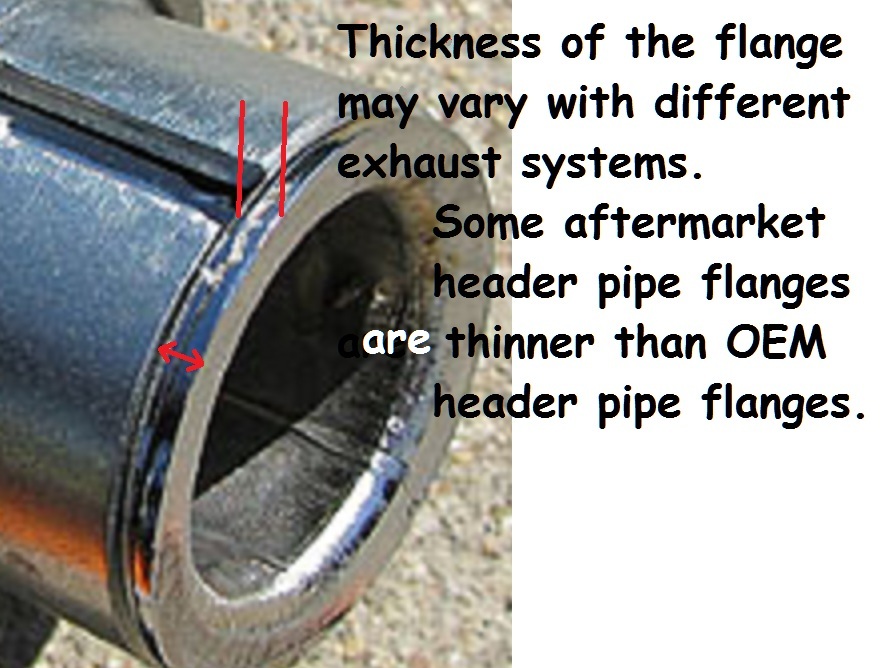

Before fitting collars you need to determine who made the exhaust system because they do not all use the same collars. From what I've seen, the stock KZ750 twin exhaust uses really short collars that are not even shaped like others I've seen for KZ bikes. Here's a pic of one from the web:
