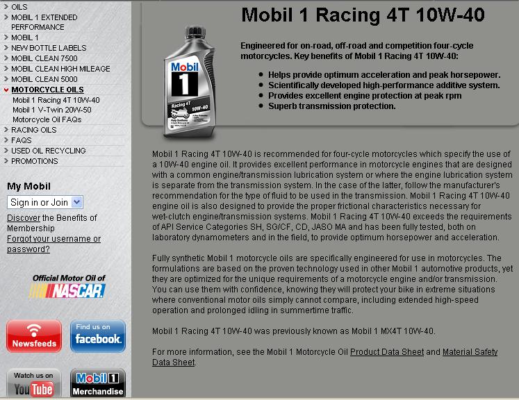

Pretty much for any oil designated with 4T Motorcycle oil designed for wet sump clutches... It normally meets the specs just fine.... Use this for engine break in periods...
Then switch to Mobil 1 synthetic...
