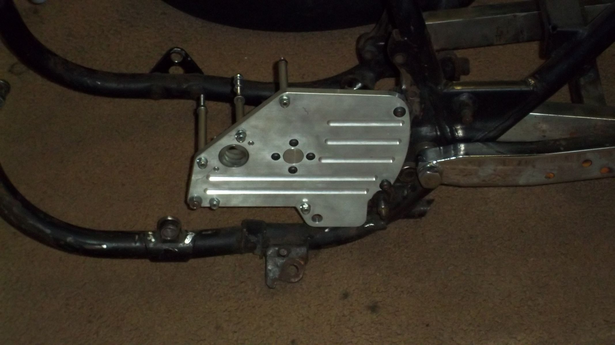

Idid use the chain guide from the gsxr

X's 5 on what everyone else said. Measure your specific set up and order the offset you need. I ended up with a custom 1.239" offset from D&G, as they were the best price for custom offsets. You should be able to get away with something off the shelf from PMFR or the like. You should be able to fit 5/8" or under offset under your stock cover. Over that and you'll be running and outboard bearing support like z1ozonly and myself. I also have one of irishwills plates, but i don't think he has anymore left. Keep us posted.
