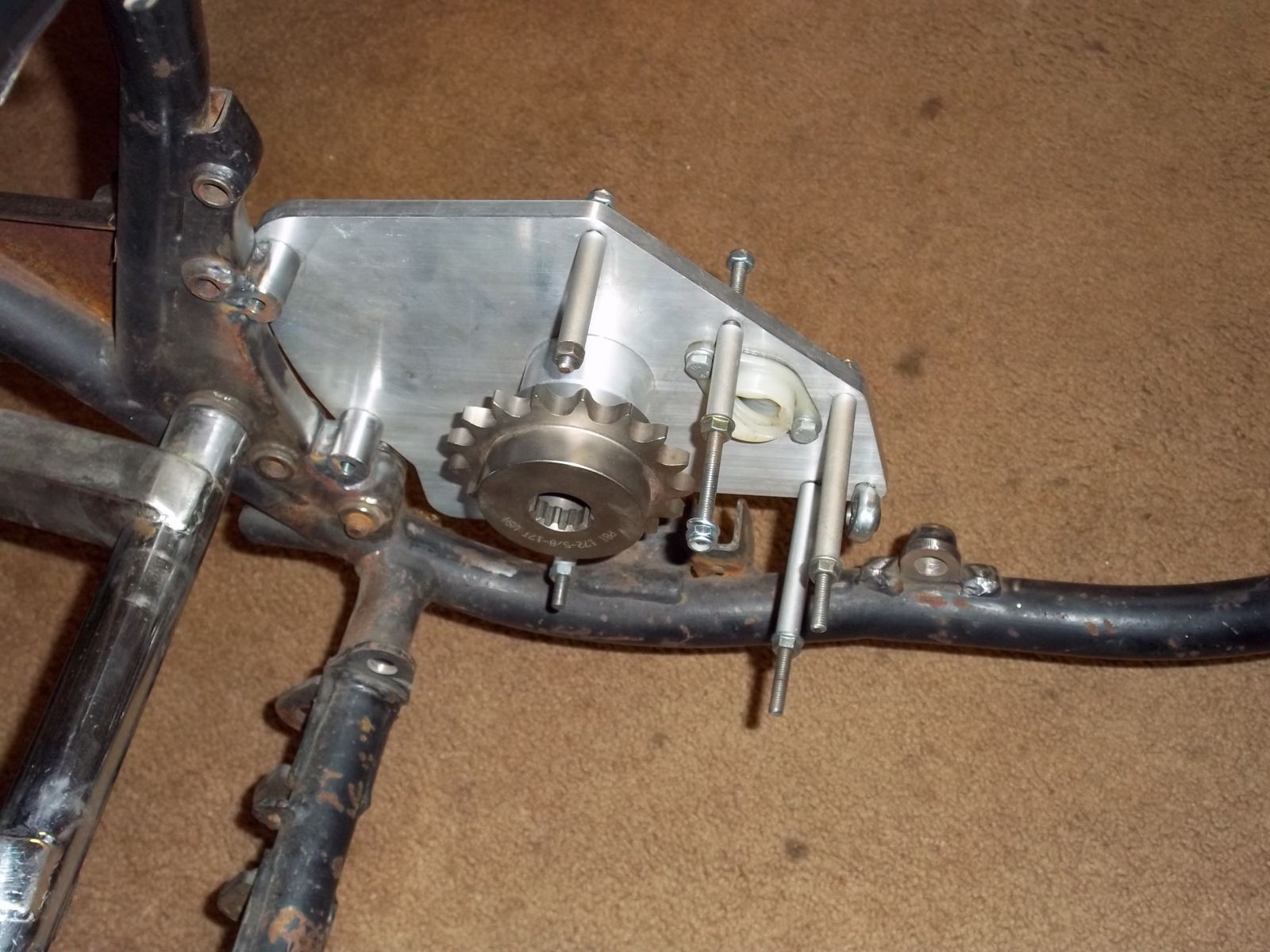

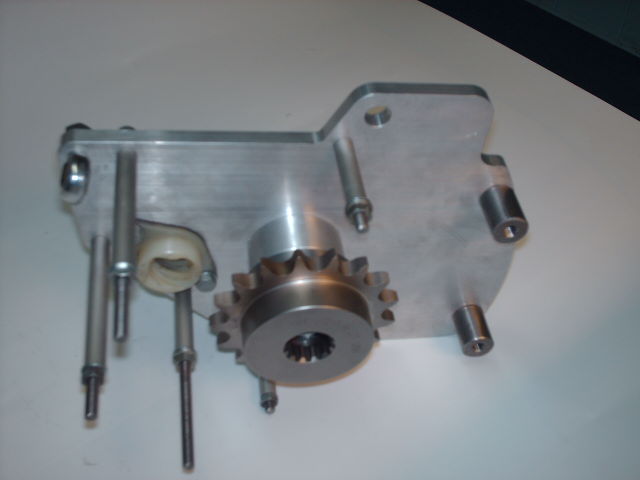

- z1kzonly
- Posts: 2824
- Thanks: 529
Re: OffSet Sprocket?
05 Jul 2012 22:17
Hey New Guy, Nice stuff! you know your stuff!
About 2-3 years ago there was a guy on here called "irishwill" he made up about a dozen of these offset bearing plates. They were made for 5/8" offset sprockets He "irishwill" does excellent work.
But you should try and find one of these plates from a dragbike style bike to use.
Irishwill was out of Canada, I paid him only $100 dollars and he shipped this plate to me.
And I bought a new PMI sprocket at dealer cost for $69 bucks.
I had this project laying around, gonna play with it someday?
I tried selling the rolling chassis for $500 on ebay, no one bought it!
But do something like this.
Good Luck, keep tinkering!
