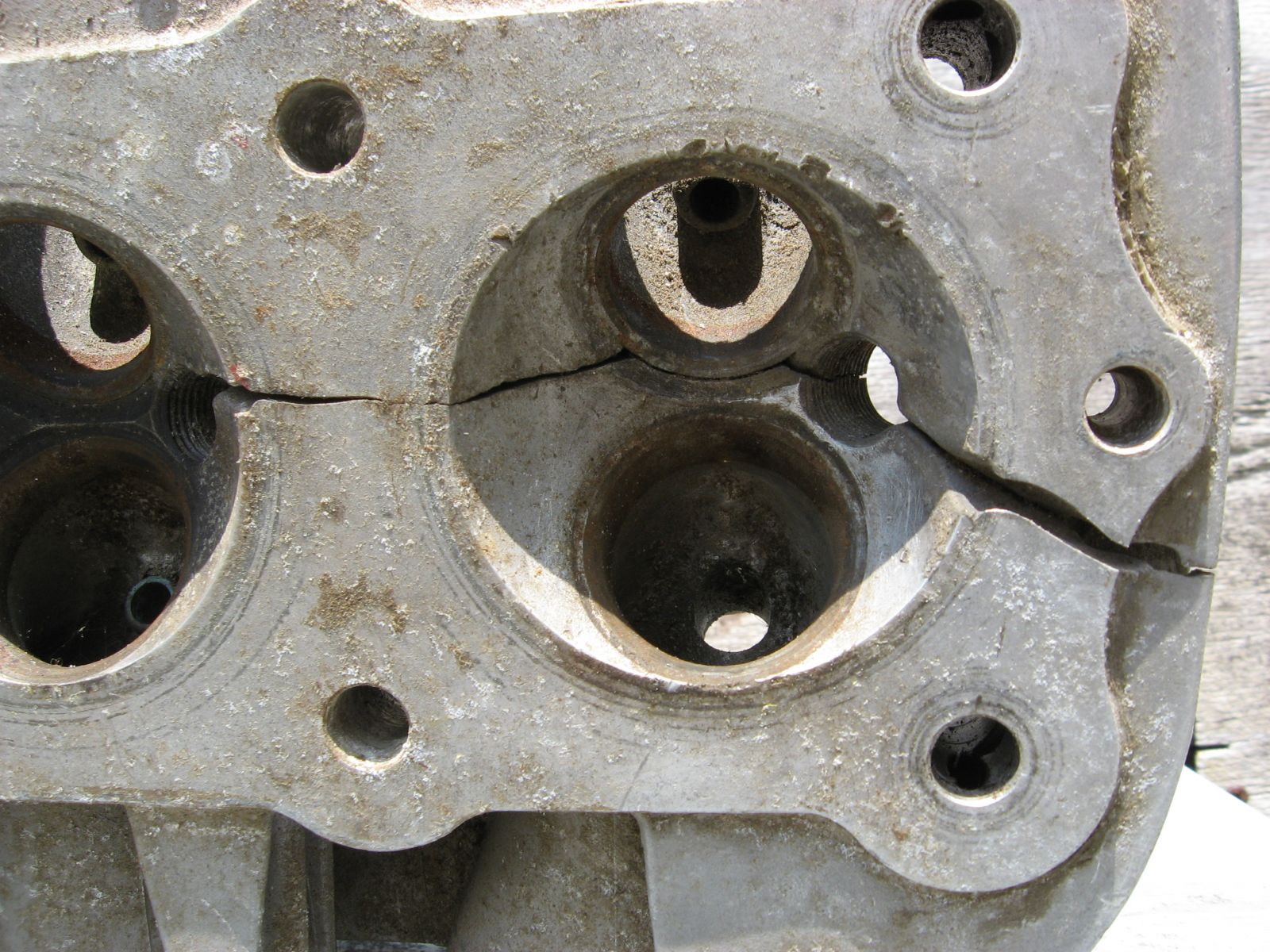

Re: Stock ignition timing, 'safe' nitrous shot?
01 Jul 2012 13:05Be carefull. Use it sparingly or you too could have a custom artifact. No more than 2 second bursts. Or spend the money on building a rock tough motor

01 Jul 2012 13:44
:laugh: Had a buddy bring me a head that looked a lot like that, wanted to know If I could weld it up. Bunch of spray and propylene oxide don't work well together.

- Posts: 5194
- Thanks: 2341
01 Jul 2012 13:53
Les , I figured on fixing this one with some J B Weld. :woohoo:
