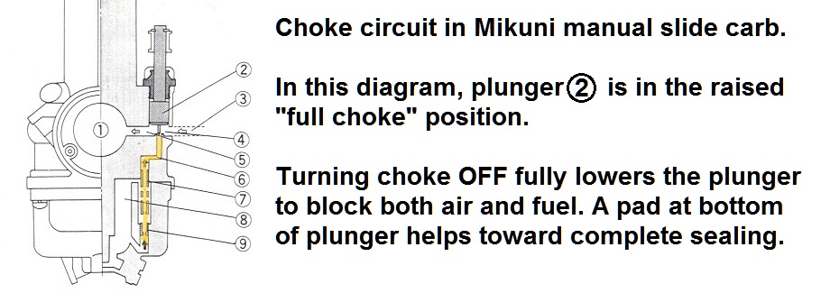

When operating the choke lever in normal fashion on a fully assembled motorcycle, should be able to watch the carb mechanism simultaneously raising and lowering the plungers. And notice whether any plunger might be failing to fully open or fully close.
