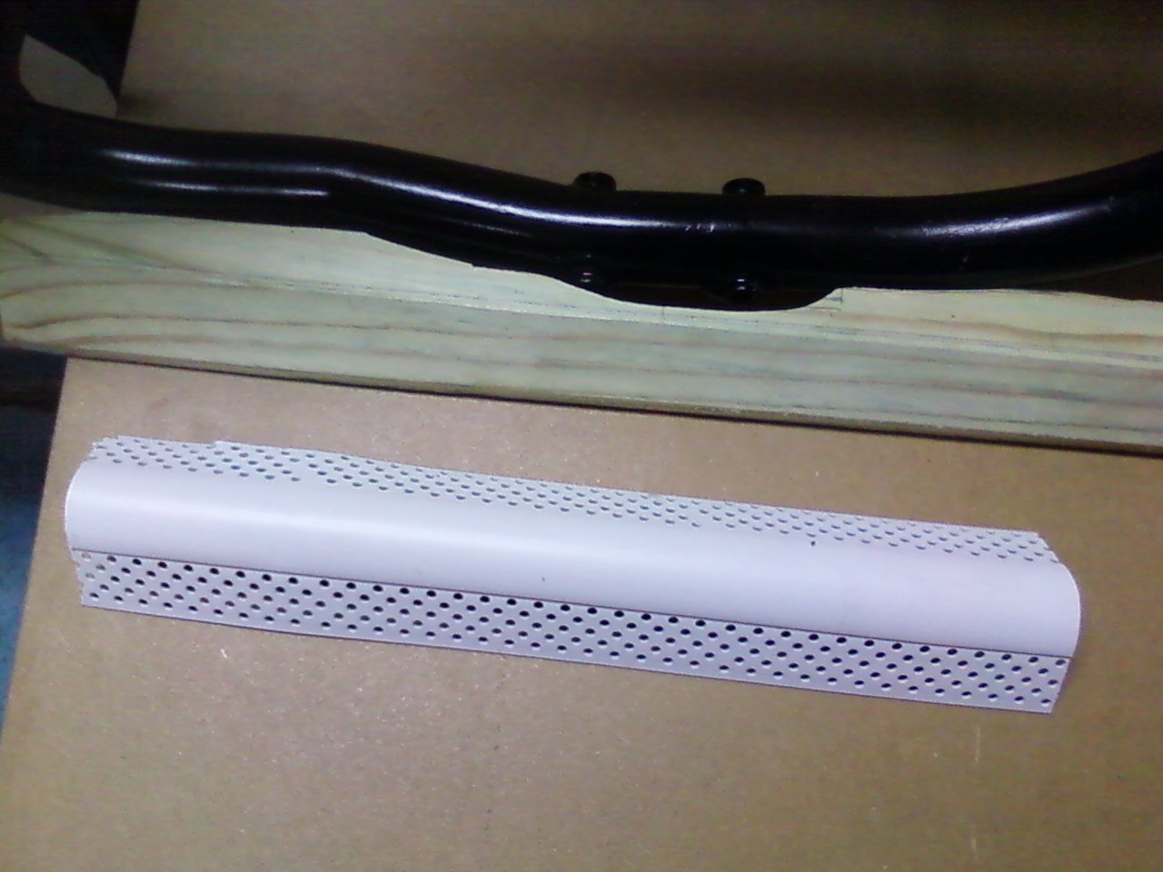

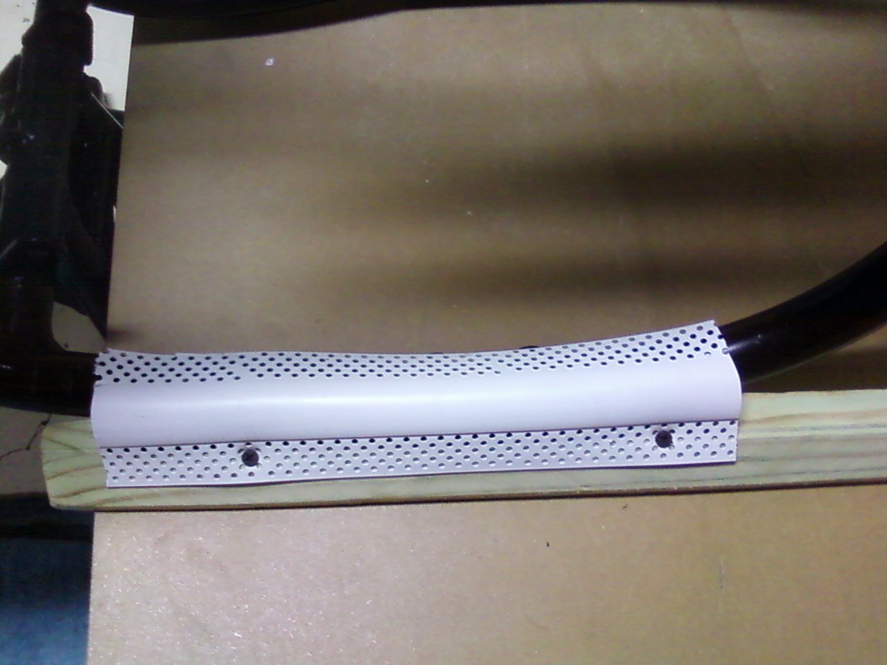

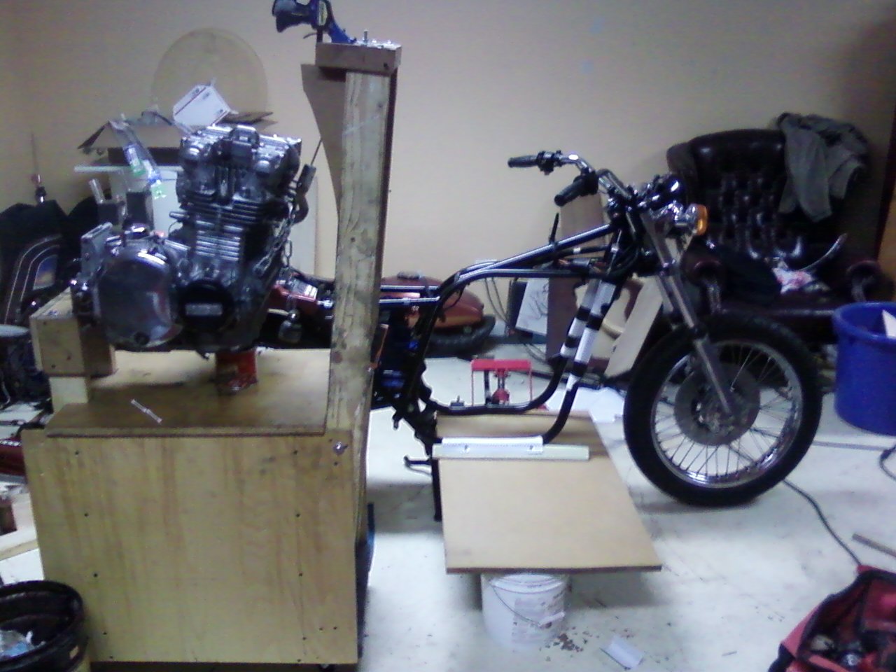

- bluej58
Less
More
- Posts: 2484
- Thank you received: 511
10 Jun 2012 12:55 - 16 Jul 2013 07:58 #527954
by bluej58
78 KZ1000 A2A
Replied by bluej58 on topic Engine swap
This is how I did mine.
Removal;
kzrider.com/forum/2-engine/489872-how-i-...ved-my-engine#489872
Installation;
I left the filter cap and bolts off for the install, big help.
Removal;
Installation;
